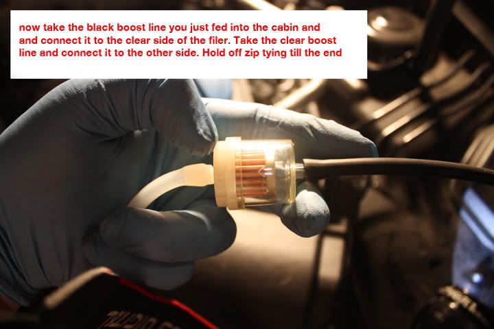

    Something else I did after I saw some other boost gauge kit was to install an inline filter. As you can see, it was well worth the install.
    You can pick them up here:
    https://www.amazon.com/gp/product/B074C4T4WS/
    Woah my filter on my boost reference line for my vc-50 hasn’t collected a drop of oil in a year. If I pull the line off the boost tap a drop will slowly drip out tho

    Not so lucky *lol*. I appreciate you finding that mutitap hose, btw, picked it up and it works perfectly!
    I did notice that my filters have a arrow in them pointing in what looks like the opposite direction to what you installed yours too. Using the clear side as the inlet would make seeing the build up a lot easier that’s for sure.
    That boost tap hose saved me from buying the IE manifold out of frustration of not having a good reference port option. Looking back, a throttle body spacer with 2 npt hook ups could be used to run a nozzle and a stealthy barb for boost reference.
    I’ve tried taking a reference directly off comp. housing of the turbo but it’s a really bad reference. Will show boost much before the map sensor will see it and you’ll never see the vc-50 reach full vac and give you the “-“ symbol. Seems like you only really see the vacuum after the throttle body.

    Quote Originally Posted by Traptalk View Post
    I found the Podi install, shout out to @phillips2024 (https://www.audizine.com/forum/showt...S4-DIY-Install )when thinking about how to run the VC-50, and found that their gauge setup came with the filter. Install shows the orientation, which is what based my orientation on.

    Oh maybe we do have it installed the same way.
    I did have a boost tap like what you were using but after the direct port modifications it popped off. Too much strain on the hose.
