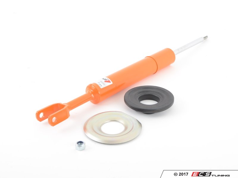

    did Koni just discontinue FSD shocks?
    I can't find FSD's online anymore,
    and they were on sale not long ago. Maybe it was a clearance to liquidate inventory?

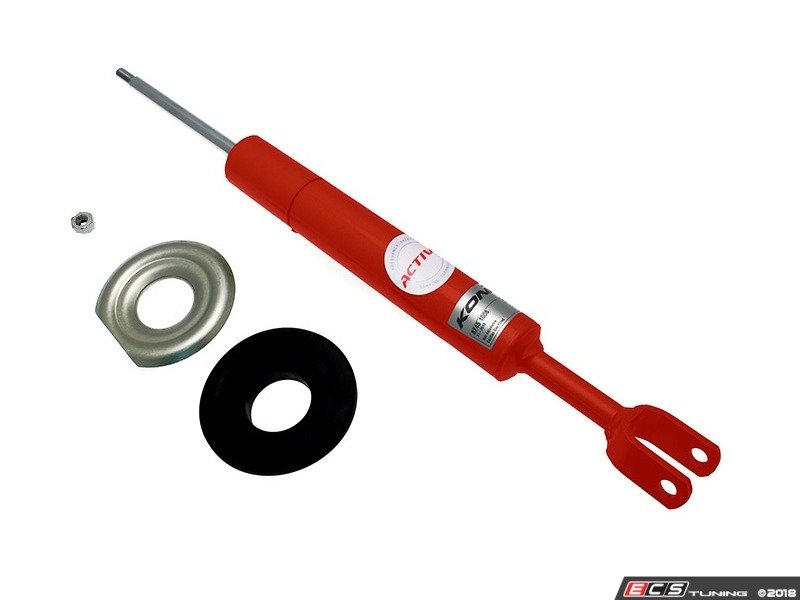

    This is what ECS shows. 'STR.T' and 'Special Active', which I've never seen before.
    Recent YouTube videos are claiming that 'Special Active' is a new thing.
    https://www.ecstuning.com/b-koni-par...pace-1011~kon/
    https://www.ecstuning.com/b-koni-par.../82451008~kon/
    Is it basically the old golden FSD's, but now painted red?
    The good thing is that new, these 'Special Active' shocks appear to cost about $430 total, not including the "up to $70 rebate" they seem to be running now.
    More affordable considering FSD's were regularly priced around $700-800, IIRC.

    Be weary of the decrease in price. My past experience leads me to believe the quality will suffer, especially with a price cut of over 40%. Then again, they could be a lower range model and not as refined as the traditional ones. Not saying this is the case, but only time will tell once people start buying these and reporting back.

    I returned my FSD rear shocks in July for replacement (the second time).
    Koni sent the 'Special Active' red shocks as replacement.
    Don't really notice any difference in handling or anything else. Except color.
    Hopefully they are more heavy duty than the gold ones.

    I'm running FSD's and stock sport springs (2003), it's a very nice combo. You can still get FSD on Amazon for the B6, seems to be some old stock.

    Sounds like road_tripper’s experience w/ FSD’s was not a good one. Plus he didn’t notice any difference between rear FSD’s and Actives. Since the Actives incorporate newer technology at a lower price point, then these might be a very good alternative for me.

    I think I put my car through very unique stresses. I drive a lot on washboard dirt roads at highway speeds. Some of these trips include 50+ miles of dirt, washboard, gravel, rocks and so on. Probably only 35 miles are driven at over 50mph though. Maybe these shocks are not spec'd for heavy use for 2-3 hours with no rest stops!
    I also tow my 3000lb travel trailer; driving 10-12 hours a day at the speed limit (not 55, californians!) with only fuel stops may or may not contribute to a bit of extra wear on the rear suspension.
    I have about 80,000 miles on the front FSDs. only about 10K on the rear Special Actives; they haven't overheated yet.
    I will say that the FSDs allow one to really speed through rough washboard though!
