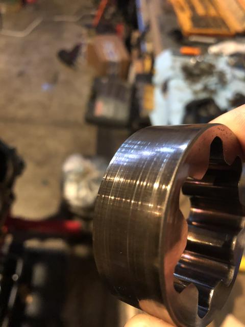

    Does anybody know the factory specs for the radial rotor and driven rotor tip clearances for the oil pump?
    I have two pumps. One is worn visually more than the other and the rotor is scored, another seems to be in a bit better shape but I want to ensure that the clearances are right and I don't have to spend another ~280 on a new pump.
    This is a photo of the driven rotor (the worse out of two).
    Toyota specs their pumps for 0.10-0.16mm, max 0.2mm radial and 0.04-0.16mm, max 0.2mm for the tip clearances. ELSA does not seem to have any info on that and couldn't find anything in google. If I can't find audi factory specs, will probably use the the toyota's numbers at least for the reference.

    Ok, I measured the spacing and the numbers were 0.102 for radial and 0.05 for tip clearances. Seems like there is some good margin so I decided to polish the driven gear.
    For that I printed a plastic gear for the driven gear on 3d printer to be able to put it on a bolt an hook up to the drill:
    That actually worked quite well with 400 and then 800 grit sandpaper.
    The clearances were still within the "toyota" specs :) Since I don't have audi numbers had to make some assumptions.
    The pump is cleaned, primed with oil and ready to be used again.
