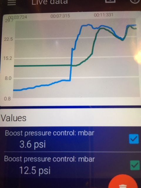

    Problem: When I stomp on it, it doesn't do much for a second or 2 and then takes off. My 0-60 is over 10 sec! I replaced the DV which was already the new version. This made no change.
    Just got an OBDEleven and checked channel 115-3,4. My measured boost at idle is super high (~13 psi) compared to other graphs I've seen posted. The measured boost lag can really be seen on the graph below. This is idle to WOT.
    Any ideas what I've got going on? Bad or dirty MAP? Anything else it could be or I should check?

    You shouldn’t have ANY boost at idle. If you’re seeing a value at idle you are probably seeing the MAP sensor sensing atmospheric pressure which should be about 900-1030 mbar.

    Your graph doesn’t show.
    Your logs at idle don’t mean anything. When you log boost you log in second or 3rd gear and you log from 1500rpms to redline.

    Hey, thanks for your reply. What your're saying about atmospheric makes sense. I'm at 4000' so 12.5psi is pretty much right on.
    I'll try to make a new boost graph like you noted tomorrow, in the meantime, here's another attempt at getting my 1st image to show.
    Let me know if you can tell anything from it? Thanks.

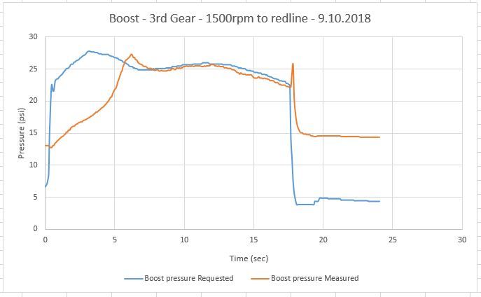

    Here's what I came up with this morning. Let me know if you see anything. Thanks.
    Active Member Four Rings EvolutionArmory's Avatar
    May 20 2017
    399735
    New Hampshire
    Looks normal.
    You see that huge gap in the beginning of both of our logs? That’s your turbo spooling up. You should have normal turbo lag below 2500 rpms. Maybe even a little higher. My car reaches full boost at 2800 rpms.
