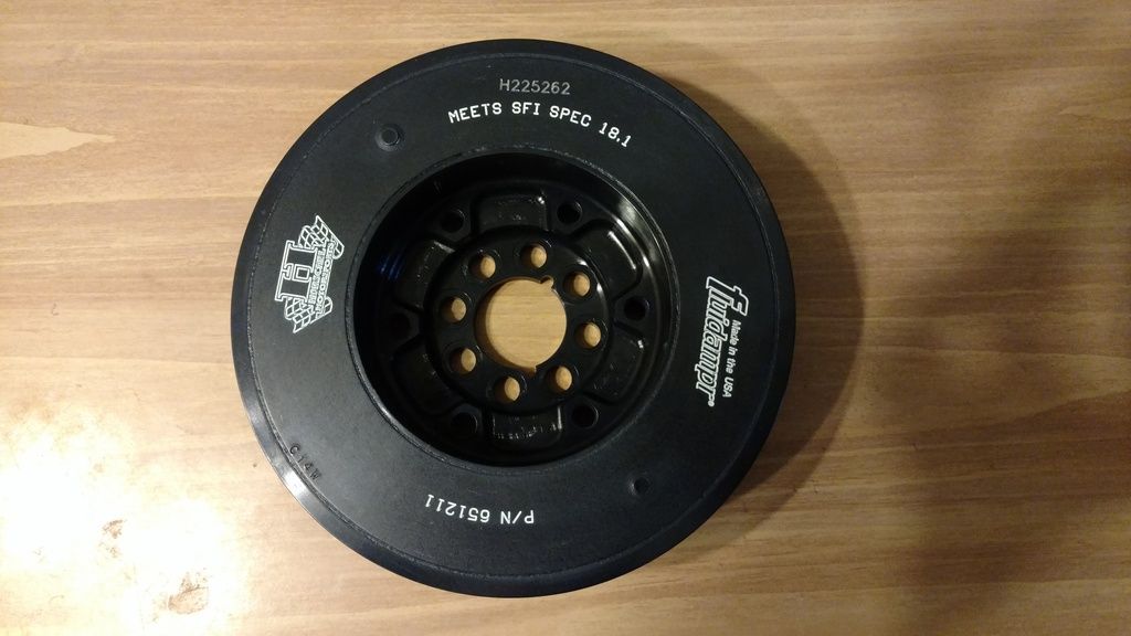

    I just purchased a Fluidampr because I love to spend money on parts I don't need for a car I don't drive. I'm sure a couple of you an relate. I digress. In the images below, you can see there is a conflicting torque spec between Audi/VW and Fluidampr. I know that there one instance of a failure with this part a while ago, so I wanted to make sure I got this right. Let me know what you all used as a torque specification.
