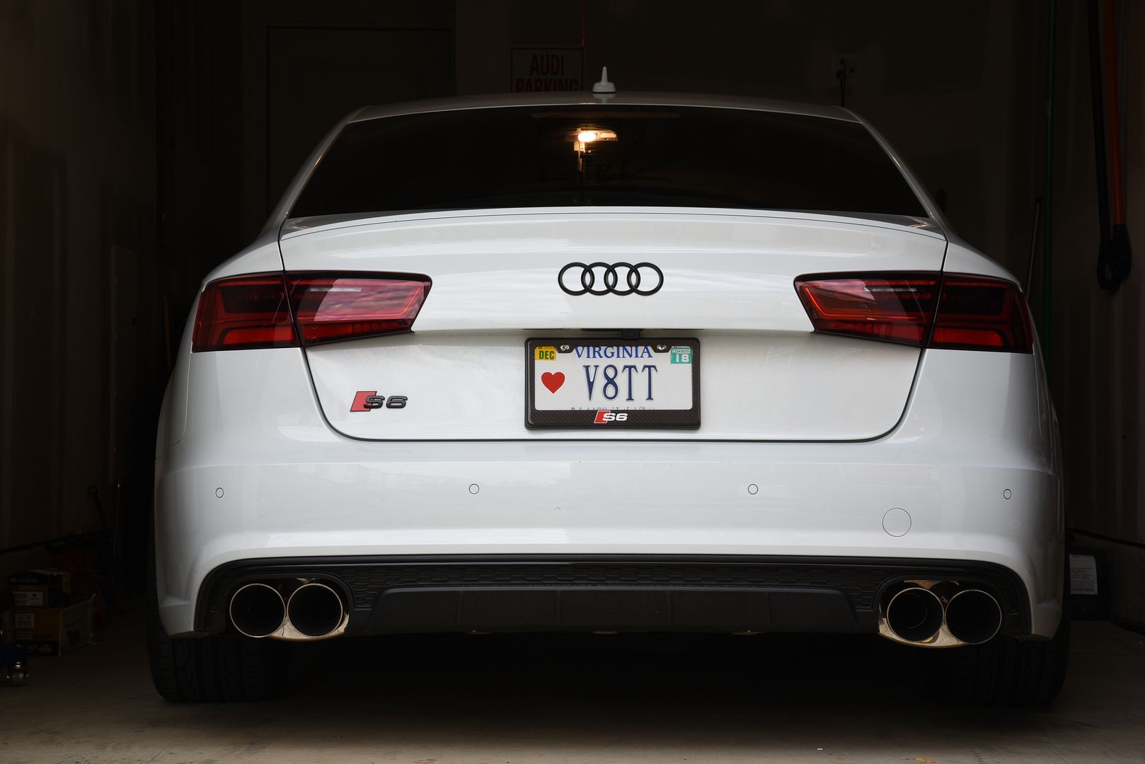

    So took a month but worth the wait. The Downpipes look like a work or art.
    Install was pretty straight forward and having already installed the APR Downpipes myself these were a breeze.
    Pros: no gas smell in the cabin, o2 sensors in stock location so no need for spacers and no CEL. Can connect any after market exhaust system that mates up to the OEM flange.
    Cons: wait period? And the neck down that Carx7 mentioned.

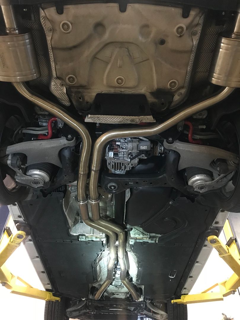

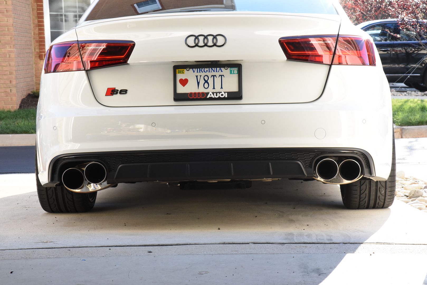

    On to the Becker catback. This exhaust is said to be a Milltek replica.
    I Wanted a catback at a decent price point. At $1100 shipped it fit the bill nicely. So project budget exhaust that performs was underway.
    Took about a week to get the catback, and once I opened the box I could see the quality isn’t the greatest but looks damn good for an EBay exhaust.
    Made of 304 grade stainless steel
    Brushed stainless finish
    Piping size 2.75” OD
    Install:
    Install went pretty well, the catback bolted up to the Russian Downpipes with ease and a nice fit. Comes with (4) 4in exhaust tips, at first I was like damn these are huge haha, but they fill the rear valence up nicely
    All the exhaust hangers are in the stock location, I had an issue getting the exhaust straight which is a hard task on the floor in the garage. The exhaust clamps are also crap, even when you tight them all the way the exhaust pieces still move and leak. I bout a better set off Amazon.
    Startup:
    This would The the first time hearing the complete package of Downpipes and catback.
    I will say I was very disappointed in the sound. I do understand as the mufflers break in it will get louder. But this setup was beyond quiet, the stock system in sport mode was twice as loud. It also took a few days of driving to burn off the oils so my car was smoking a bit.
    Fast forward to now. I have 1500 miles on the setup. When you push the start button people know to watch out as it sends that initial bite of fury out the back! But after the cold start when the rpm’s go down you can barely hear the V8 gurgle at idle and even worse with a few revs in neutral.
    My Roc Euro intake is the loudest thing on the car, even under WOT all intake and swoosh noises. A few friends have commented the exhaust sounds good from the outside but being the driver the in cabin sound isn’t there. I was trying to convince myself it was the good sound deadening the car has.
    The exhaust a WOT is loud enough to be heard, and crushing speeds in D mode there is a slight drone under 2 rpm, anything above that it’s hard to hear anything. The exhaust does have a deeper tone though, but the burbles and crackles are almost no existent. The stock system definitely wins that battle. I was also trying to decide was it the catback or Downpipes making this setup so quiet. The APR Downpipes matted to the stock exhaust was a way better option for the money and sound.
    After a few dreams of a louder exhaust I contacted a local shop and I will have them
    Remove the resonators and middle muffler to waken this setup up. I’m not concerned about drone at this point, I have a daily car and having a motorcycle with exhaust it honestly won’t bother me I’m sure. All my last Audi’s have been catless with straight pipes or one muffler anyway.
    Pros: fits pretty well, quality is decent considering the price.
    Cons: too quiet, crappy exhaust clamps. Wish I had just purchased the AWE track exhaust as that was my first choice initially.
    I will be attempting to upload the sounds clips I do have. And will update again once I get the mufflers removed.

    UPDATE:
    Was not satisfied with the sound so I had the exhaust setup modified.
    The result was a deep growl and snarling bite upon accelerating! I'm def liking the new setup
    The Shop made suggestions and the end result was Resonator and Middle Muffler delete, welding all the area where a sleeve joint existed except for the rear axle portion where they installed V-Band clamps.
    I have a few videos from the weekend, enjoy!
