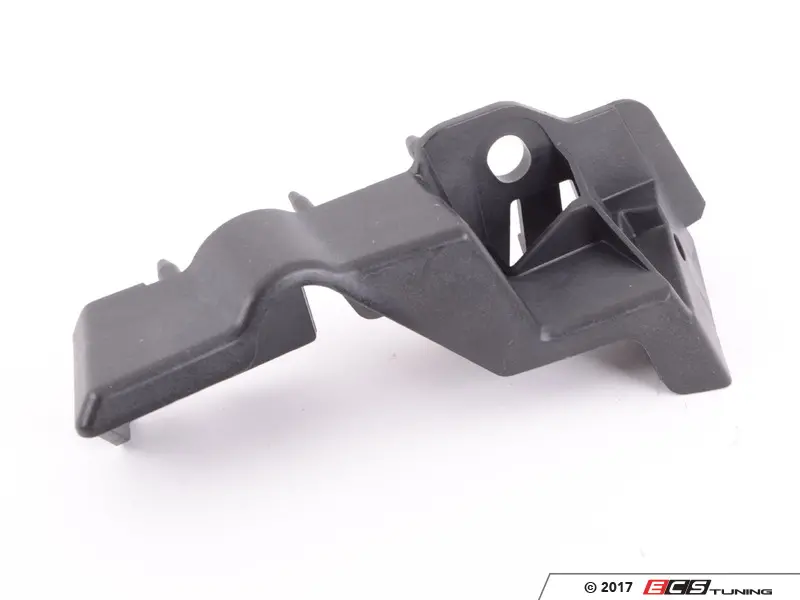

    Quote Originally Posted by eljay View Post
    Which part are you waiting on? I ask because the upper covers bolt to the bottom piece and the grille. There is no other mount there on the bumper itself.
    The bracket under the yellow boxes in the first picture. You can see they glued that piece to hold it all together as its all broken:
    2019 Audi Q5 - 28k; Arctic White; Black Optic
    2003 Mercedes ML350 - 166k; Gray
  12. #132
    Veteran Member Four Rings eljay's Avatar
    Aug 13 2015
    348695
    NS
    Ah got it! I missed the first picture.
    That piece is actually not meant to hold those two pieces together as you've found out. Rather it secures the bumper to the fender if I recall that correctly.
