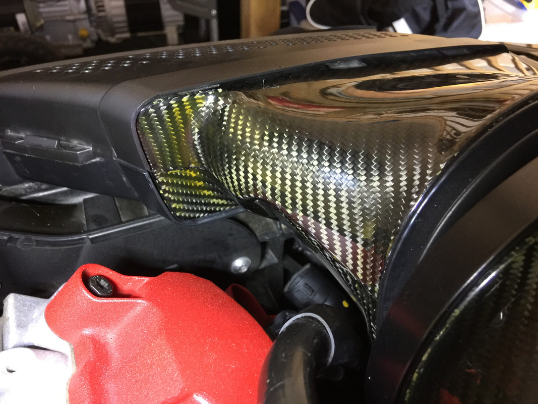

    Today I took a long look at the Eventuri intake.
    About 70% of an engine's intake restriction is in the cylinder heads. Yes, it'll vary by a few percentage points but that's a solid average number for a 4V head. That's in the cylinder head alone, doesn't include the intake manifold or the intake.
    I wonder if Eventuri would give us the surface area for their redesigned filters. We need to compare that to the OEM or K&N filter. If it has less surface area overall, it won't flow as much air. No way around it unless we're talking forced induction

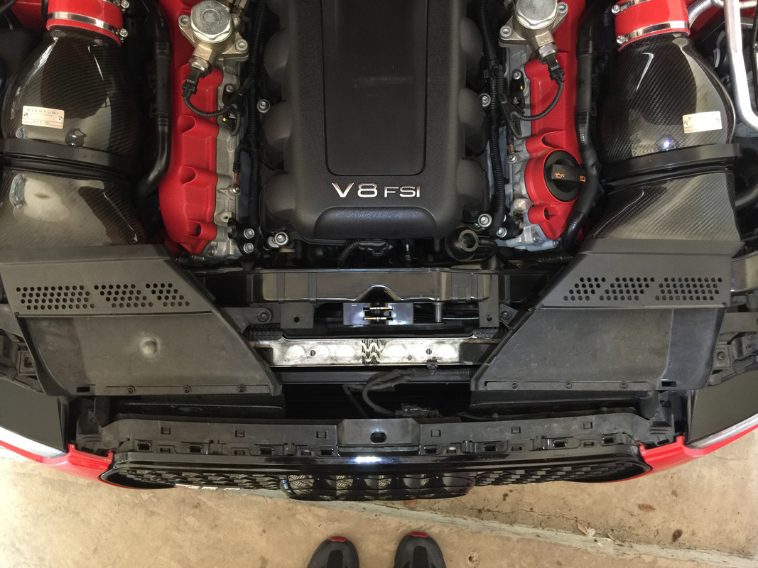

    Our airbox will NEVER see positive pressure with the way it's designed. It is not, in any way shape or form, a "ram air" system. To look at a true ram air system, take a look at something like the Aprilia RSV4 or the Kawasaki ZX-10. Even then, the airbox doesn't see pressurization until triple digit speeds. Therefore the intake is always under vacuum, it's always sucking air in.

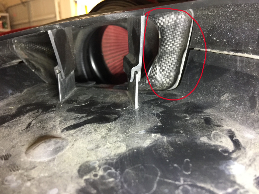

    I took the "scoops" off after looking at how they sit against the top of the radiator. James had mentioned the slight redesign of the front scoop system. There's a piece of metal that gets bolted to the plastic OEM intake front lip and to the top of the carbon scoop. It mates the two together. Now the floor of the carbon scoop and metal connector, what the airflow hits and flows up towards the mouth of the OEM intake, sits below the front support for the grille. This is a thick black plastic piece. At any given angle, there's about an inch gap between the top of the plastic support and the carbon/metal scoop. It's a mail slot.

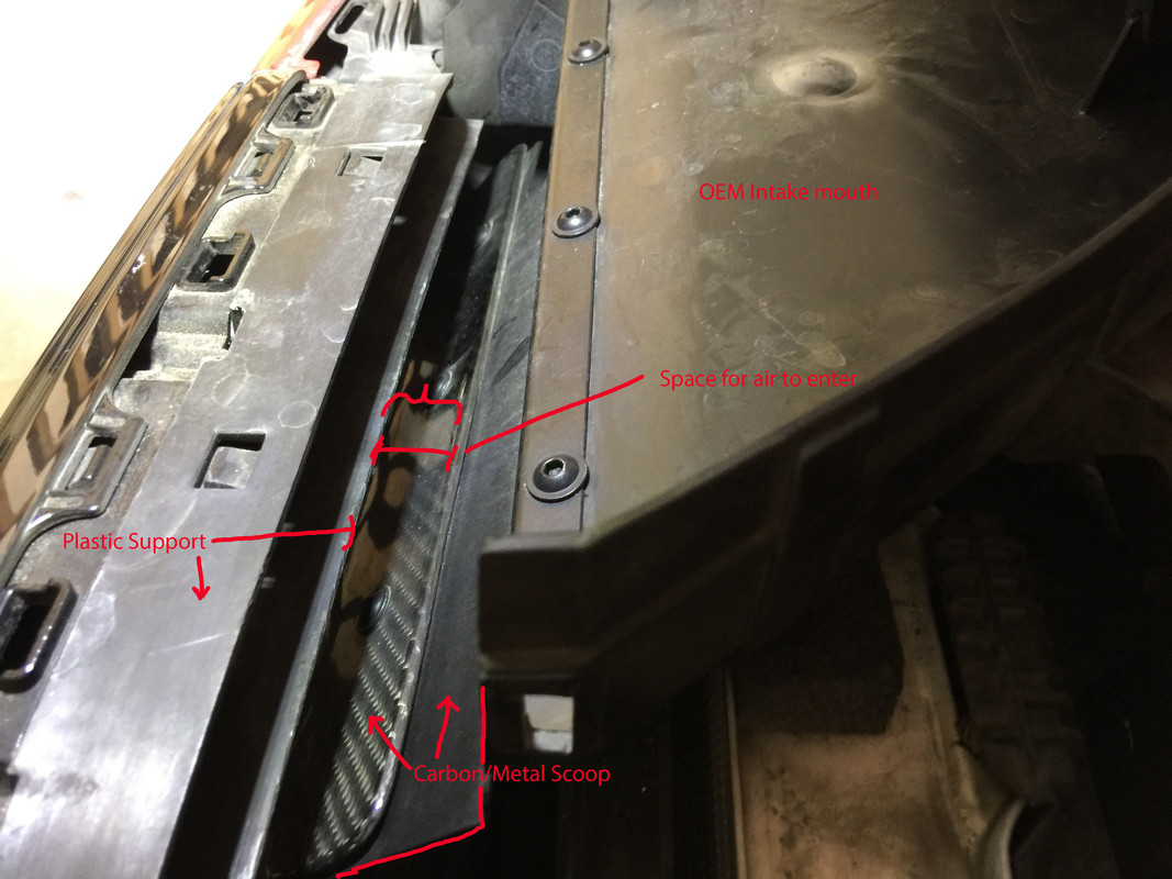

    Here's a photo, front of the gar is on the left. You're looking at the passenger's side.
    Once the air makes it past the radiator, hits the scoop and shoots upward over the a/c condenser and radiator, it enters the OEM portion of the intake's mouth. There are two dividers which help to direct airflow. The Eventuri portion of the mouth forms a hard wall on the right inboard portion of the mouth and to me, it looks like a restriction. Best I can tell, there's no reason for it to be there.

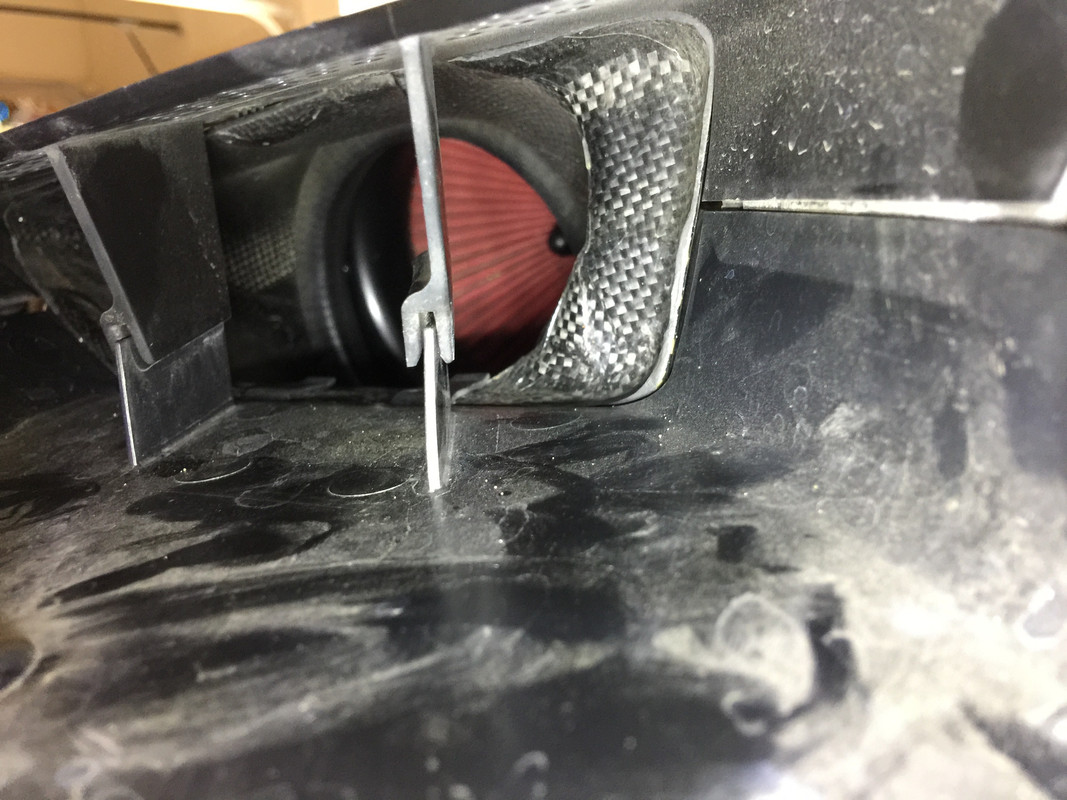

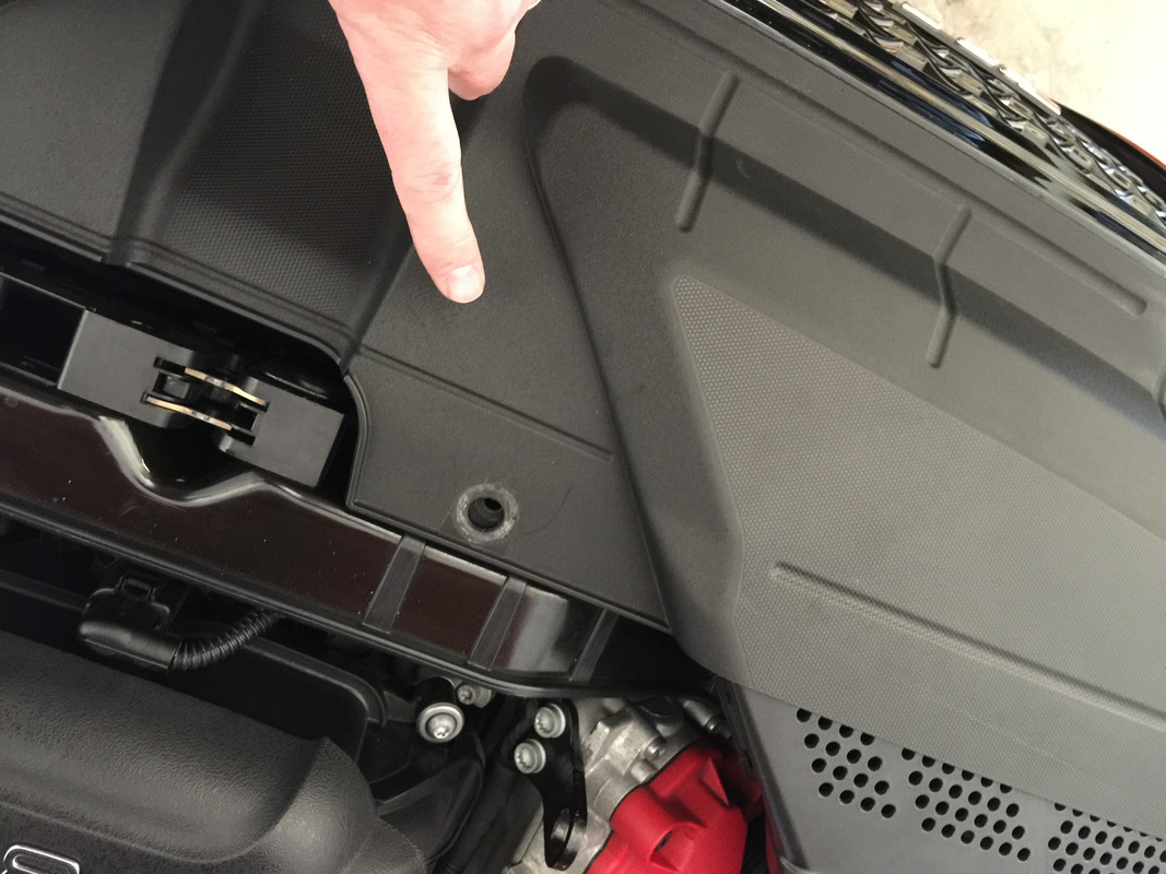

    Inside shot
    Little better angle..

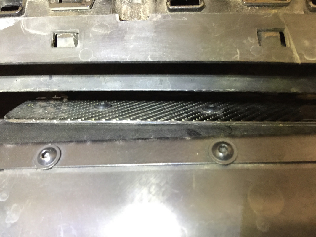

    Here's a shot of that same intrusion but from the outside with the scoop installed. There's no real reason for it AFIK. I'm not sure why they didn't just make it a smooth transition from the outside edge of the OEM scoop to the leading edge of the bell mouth. Maybe they saw something in their fluid dynamic computational models.

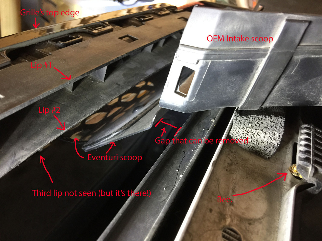

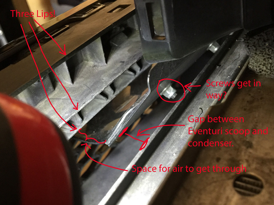

    Looking through the front grille, there's a big piece of the grille support which blocks the top edge of the intake scoop. The S3 guys apparently have a similar edge and end up cutting it out to make the air path more direct and larger. It'll never be a true ram air without a fully sealed intake mouth and box.
    <a href='https://postimg.cc/image/xod7ic761/' target='_blank'><img src='https://s20.postimg.cc/xod7ic761/5_EC85_FB7-94_E6-4_B72-_B003-75083_CAE3544.jpg' border='0' alt='5_EC85_FB7-94_E6-4_B72-_B003-75083_CAE3544'/></a>

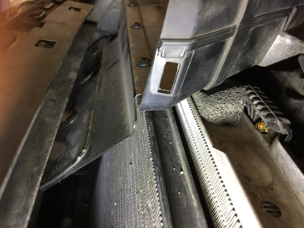

    To top it all off, that grille support has three lips which look like they could be trimmed, not just one.
    Another look at the air intake "slot". I think there's still room for improvement in the actual angle of the scoop. There's room to move the floor back towards the condenser and increase the angle of the carbon scoop from horizontal to even more vertical. Honestly, a sealed snorkel would probably work just as well, no scoop needed.
    I think this design was implemented to preserve the mouth of the OEM intake. I do think it can be designed better and the OEM portion eliminated.

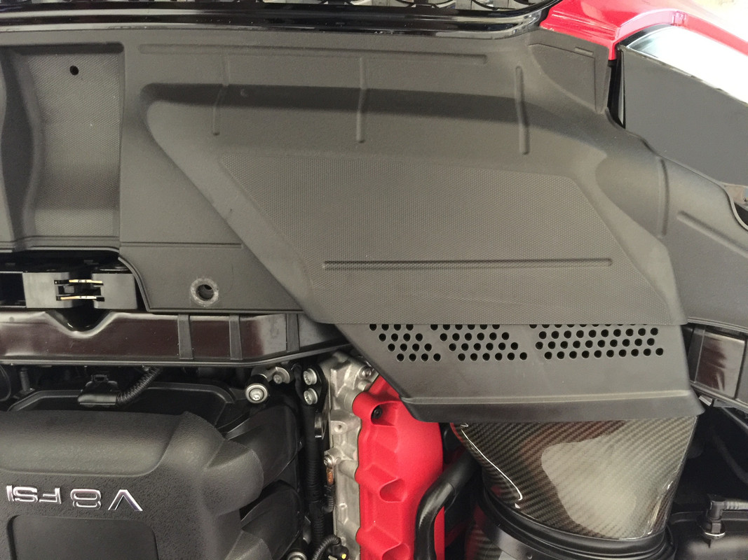

    Shot from the top. For the life of me, I can't think of what the cheese grater holes are for other than to possibly prevent hydrolock. It'd have to be one hell of a puddle for that to even come into play though. Seems like one could seal that up. If you look at your hood, you'll see those holes superimposed by the dirt that gets sand blasted onto the paint.

    I share your thoughts on those lips, I’ve been tempted to remove the grille and go at them with a dremel or make a matching upper scoop to smooth out the airflow (those sharp edges will create turbulence).
    The cheese grater holes are there as a safety net, remember Audi builds these to run in the snow and that front grille could soon block up on a bad day. I carbon skinned my holes over, it made no difference, at least not anything I could notice.
    Take a look at the OE routing too Michel, it hits an even worse wall as it enters the convoluted tube, once in the airbox it has to change direction twice before it heads to the throttle, from that perspective Eventuri have made a big improvement in flow.

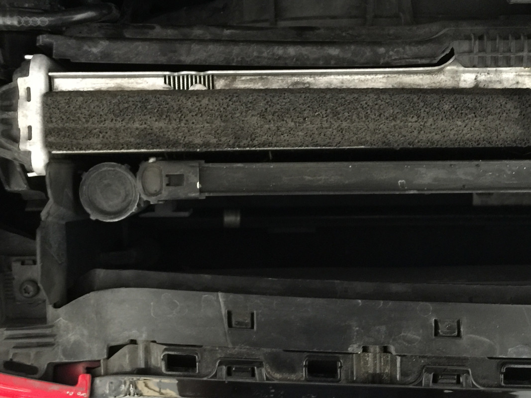

    Taking the radiator cover off and looking at the top slot, the area in between the front grille and the condenser/radiator, I thought utilizing more of that along the width of the entire front end might be beneficial. There seems to be room for an increase in the width of the ducts overall and using a new radiator cover to help in that department.
    Get rid of this and increase the width of the mouth?
    If I have time on the dyno, I'm going to try a few things like making a run with the radiator cover off and also maybe with the whole front section, the scoop, removed altogether. I realize at speed, there's pressure buildup and cooler air being forced through the heat exchangers and up into the intake mouth and there's probably a definite benefit to that at speed. So the test won't be real world applicable as we'd never drive around sucking hotter air in than we would otherwise with the scoops.
    Air will always take the path of least resistance so trimming up those edges on the bumper support is going to help too as it'll probably reduce turbulence like you mentioned.
