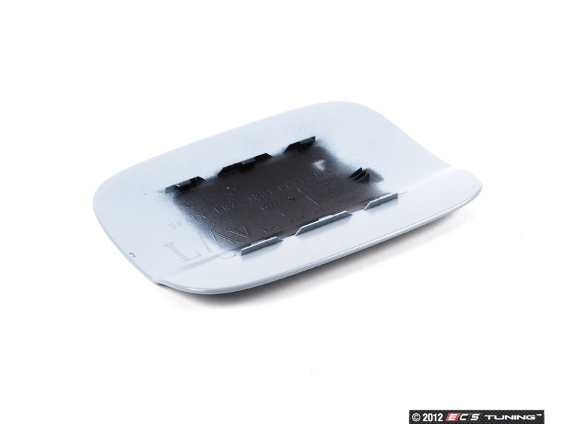

    So the hinge assembly is still attached to the car body, including the portion of the hinge that the fuel door cover is attached to? The hinge part that swings out has the fuel requirement sticker on it. If so then you're saying that the fuel door cover popped off, and that the hinge assembly is still intact.
    The cover has a plastic piece attached to it that allows it to snap onto the hinge, from what I can tell. Here's a pic from the ECS Tuning site, that shows the inside of the fuel door cover (Part #8K0809907GRU) that has the attachment piece. Does the inside of your fuel door cover have this piece on the inside? Does it look like any of the plastic tabs have broken off? I've read other threads where guys' wives have forgotten to remove a fuel nozzle from the car and started driving off, resulting in the fuel door cover breaking off. At any rate, if the tabs on your door are still intact, it may just require being slid back onto the hinge portion. Please update us with what you find!
    Edit to add a couple more pics showing the tabs on the inside of the fuel filler door cover ...
    I am the second owner. No accident history.
    Yeah. That is the part that fell off. A couple of the tabs on the top are broken. I slid it back on the hinge assembly and it is a bit loose but it should stay. I went to the dealership and they said they will replace the part. Luckily I am still under the original warranty so it will be covered but the new part has to be painted and everything so it will take a while to get it back to normal.
