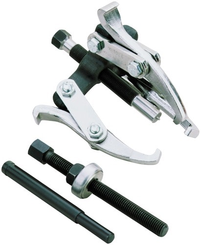

    for anyone doing a rotor change, just rent this from oreillys.
    no banging, just turn that ratchet lefty.
