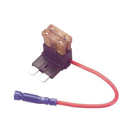

Add-a-circuit so we can power the Apt-x module

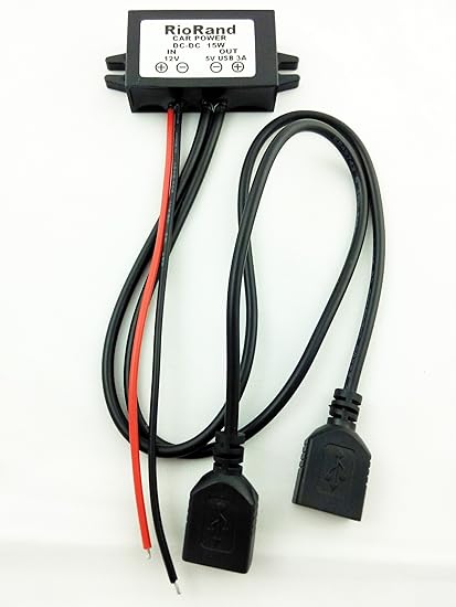

USB Power for the adapter

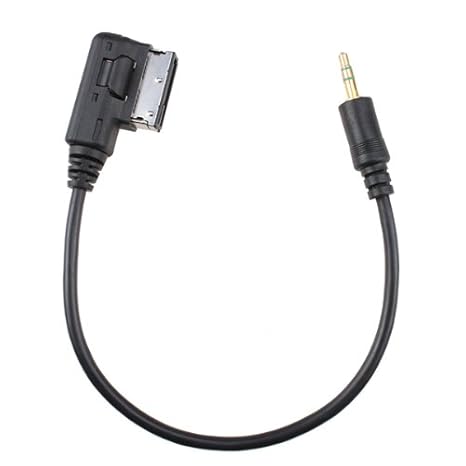

The MMI Aux adapter

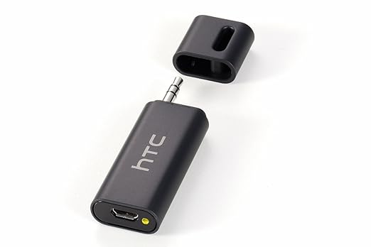

The Apt-x adapter

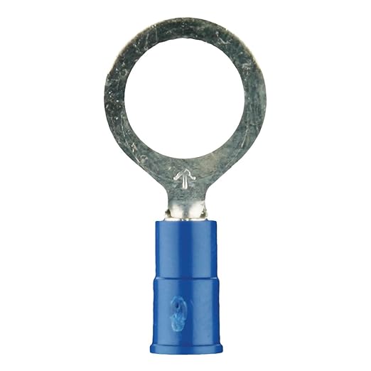

16 gauge 3/8" terminal ring connecter for the ground

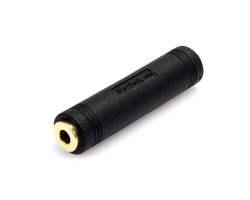

http://www.amazon.com/gp/product/B00...?ie=UTF8&psc=1
3.5mm to 3.5mm female to female adapter to hook up the MMI adapter to the Apt-x adapter

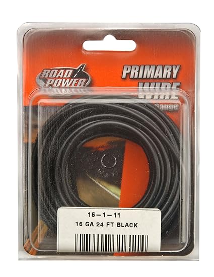

http://www.amazon.com/Coleman-Cable-...=16+gauge+wire
Extra wire to give us some room to work

2) Remove the rearward purple fuse holder and use the bottom fuse to install the add-a-circuit
3) Feed the wires for the USB power box through the small square hole in the glovebox that connects to the fuse box.
4) Ground to the bolt on the firewall at the top of the fusebox using the terminal ring connector
5) Mount the USB power box in the glove box
6) Plug in the MMI adapter to the car, then the female-female adapter, then the Apt-x adapter
7) Pair the Apt-x adapter, and listen to high quality streaming music!
