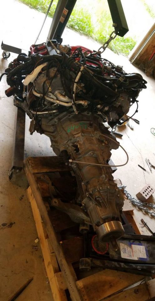

    Hey, Audizine. I've been working on a project in the background for a little bit here, and now I figured I'd show where I'm at.
    I picked up this 2010 A4 with a seized engine
    The body of it was immaculate, so I got to talking to the guy and cracked a deal. Upon seeing this, the gears immediately started turning and I decided to see if it was possible to do what I wanted to do. What did I want to do? Stick a 4.2 V8 from the S5 into it of course! To be frank, I would have loved to throw the 4.0 TT in there, but it's not quite in my price range :(
    So one ebay find later, and there she was
    What a beaut.
    Now those of you who have ever done anything like this, I'm sure youre asking "why didnt you buy a donor car? It would be much easier." And you're completely right, I agree, in fact during the planning stages that was the plan! Unfortunately for me, I'm an absolute goon who completely forgot about the option even existing and bought an engine.
    So out comes ol betsy, I did my best to restore life but she was bound up tight. Still have it if anyone needs any non internal parts, or a working automatic transmission
    After a few mount changes and some hardline replacement, the time was encroaching "stuff the thing in there" time. So I did a quick run-through on the engine, oil change, and a carbon clean
    It was getting rough in there, so I'm very pleased I did it. I tip my hat to any of you animals who did it while the engine was in the car, I was driving myself nuts with it completely out! Well, now that that's done, here we go
    Get er lined up, and
    Badda bing badda boom, she's in. Jokes on me, I take it out and place it back in two more times as the project continues. Well, I changed the engine and will need to change the transmission. If I'm building a car, why not make it a manual? So I am.
    It feels right, I am very excited. But what is all this to hook to? This unit of course! Thanks American Auto! So I go to hook johnnies up, and what do I see? Wait, that's not a stud... that's a broken bolt! 3 of em at that! Oh boy, here we go guys. So I spent a few days on and off drilling, chiseling and twisting these little guys out. I guess I didn't take any pictures, because I only have one after I managed to twist a bolt out without it breaking on me. Pro tip: Hammer a cheap spline socket on the end, big enough it actually goes on but small enough the teeth cut into threads and grip it. Pardon my french here, it had been a long day
    Tap size for these larger upper bolts is M12 x 1.75 for any of you unfortunate enough to need one. After cutting a rather large pile of collective material out of it all, she was done and my threads are as clean as a bucket of soap. So I made a maneuver and fandangled my engine and transmission into becoming buddies.
    Ft. USP motorsports stainless clutch line there. I don't have a review yet, but it saved me a lot of headache so far and I'm pleased. Great build quality, too. Anyhow, I'm also currently doing some recoding on the car with the Ross-Tech VCDS Hex V2 and their forum has been very helpful to me. While doing that, I'm also building custom headlights. The b8.0 lights arent very luxurious, but the inner design is gorgeous for an LED array
    That grey/silver swoop in there caught my eye immediately, and I intend to make flowing signals and a DRL on that. In addition to various things for my own amusement, like changing colors and having rainbow effects of course.
    Later today I will have the engine and transmission in, hooked up, and possibly ready to go. With a few changes, and if I actually put the 3rd pedal and replace the brake, she may just want to give us a rumble.
    Ill keep you all updated!

    Boy, I hope these images work cause they're not showing up just yet
    Bingo

    Yes, in fact I was looking to do rods/cylinders/rings and the rest supporting to go beyond what stock internals do. I talked to Jake here in our forum about it, speculating what could be made without annihilating the block. Would be an absolute dream to be able to, however I just don't have the funds right now. I like the JHM kit, though, because its power can scale with the engine if I were to actually build it. That and I just like JHM anyway
    With this comes an update: she's in, now to plug it all up

    People would wonder what kind of exhaust this 4 cylinder has haha. Catless + muffler delete is the basic plan now. With some lighter weight parts, the exhaust and a tune w/93 it should be a pretty fair powered car, too. Fun to rip around in. Down the line I will do suspension and such, but running and driving is my goal right now.
    Currently wrestling the new pedals in, I'll bleed the clutch and all that, and she should be good. If my recoding on the ECU is accepted, it might just start for me. In which case it's "throw it all together as fast as humanly possible and take it for a rip" time

    I've run into some issues with the manual conversion and the ECU. Apparently the ECU, upon seeing any issue with any module I have, will entirely cut communication to it and not reinstate it again. This includes my entire transmission 🙄 so now I'll have to go about wiping the module and long coding a lot of things before putting it back in together. Unfortunately, wiping an ecu isn't as easy as it sounds, and requires Audi Germany to send you the ECU files (immobilizer included) through a secure connection, that not even the dealership can do themselves. So it's an ordeal to say the least
    I'll get past it, no project would be good without some difficulties I guess. Plus, it has helped me learn quite a bit about all this

    That is what I am currently using, actually. These ecu's however are setup so they can only be used with their own exact car setup and nothing else. This includes everything from instrument cluster to the window motors (no joke). Everything is module based, and it will refuse to communicate with anything it has an issue with. I'm working on changing that currently, but otherwise it wont even pay attention to my entire transmission control unit because it doesn't like it. Entirely wiping it, or "virginizing" it is what I hope to do, and I've gotten in contact with some pretty experienced and knowledgeable people about it. It would think that the trim levels of the car as is should be the way it should be, and run entirely like OEM with immo and all.
    The build is gonna happen, whether the dang ecu wants to dance or not! I did just get my rear diff in, unfortunately not sports diff. That requires a whole gaggle of additional parts and wiring, since it is electrically actuated. Ill just have to manage without it. I also told the car that it isn't getting washed until it drives itself out of my garage, so right now its absolutely filthy. Might motivate it a little.
    Thanks everyone for the support, I'm really happy you all like it and I like the suggestions thus far!
