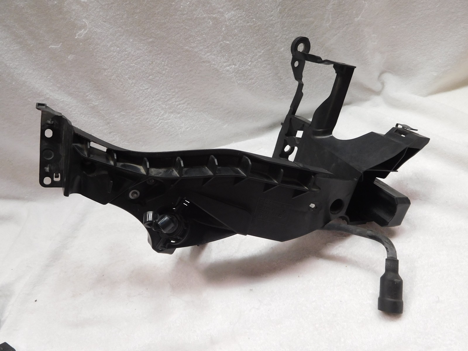

    I am assuming it's this sensor located on the headlamp support bracket which I have circled here from a photo with my bumper off
    How do I go about getting to remove the sensor, from the engine bay? Take the headlight out? Here is a photo of the sensor (brown) on the headlight bracket

    Veteran Member Four Rings fmzip's Avatar
    Aug 21 2017
    405420
    Airbag light
    Quote Originally Posted by fmzip View Post
    https://www.ebay.com/itm/13-14-15-AU...IAAOSwtIxakE2x
    FIXED......
    So yes, it’s the sensor above. To access it remove a few torx screws on the fender liner and peel it back, just like you were replacing a fog light bulb. Clear code with Vagcom, done!
    And yes my car is still under warranty but for a $60 fix, saves me time and aggravation of going to the dealer, reflashing my car, etc. etc.
