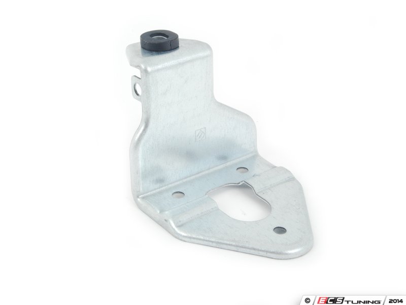

    So, I took a look today and I found at least one issue, and I need some help finding the part. There is a hairline crack forming in the mounting bracket that holds the motor & transmission. I tried looking for it on ECS & Genuine Audi Parts, but it isn't listed with the other wiper hardware that I can find. Can anyone find the part number of the bracket that bolts down in the center of the assembly and holds the wiper motor? I did get it a little bit better than it was, but I don't know if the transmission assembly will be able to retain pressure on the windshield with this part being cracked. It also flexes quite easily when I put any pressure on the wipers, so that can't be good either.

    I got out of a training class much earlier than expected, and given the weekend forecast looks like nothing but rain, I replaced the bracket this afternoon. Replacing it was actually easier than I expected, though the cowl was still a PITA. Once I got it started coming out, I put on a pair of gloves and was able to run my fingers under it to get it out the rest of the way, which wasn't bad actually. Here's a picture of the bracket too, which was probably a rain storm away from breaking completely as there was only one crack when I looked at it earlier in the week that was maybe an inch long. I did almost break things worse though as I finished up. Despite cycling the motor 4-5 times before putting the wiper arms back on, it decided it wasn't at its resting position randomly and was maybe 4-5 inches from down. So after I tightened down the arms and went to check them, they proceeded to park themselves under the hood. Fortunately nothing broke, and everything looks good now. It also helped get rid of some streaking that I was seeing after I tested it out with the wiper fluid, so that is an added bonus.
