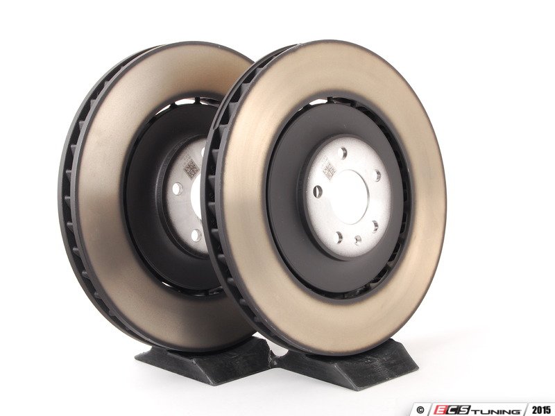

    The rear rotors on the S6 & S7 are ventilated, but they are one piece.
    Mar 29 2014
    167502
    Hampshire, UK
    Quote Originally Posted by wwhan View Post
    Yes they are cast as one piece l agree.
    Only the ceramic rotors are two piece on the 6/7 platforms, where the friction rotor is bolted to the hub fitting.

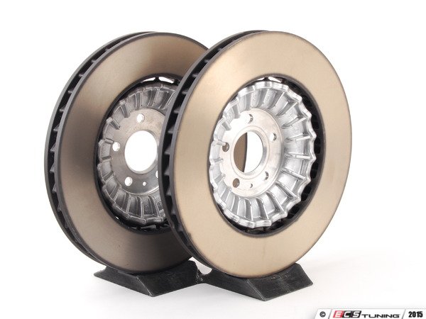

    The Audi c7/c7.5 S6 & S7 OEM front brake rotors are two piece.
    https://www.ecstuning.com/b-genuine-.../4h0615301mkt/
