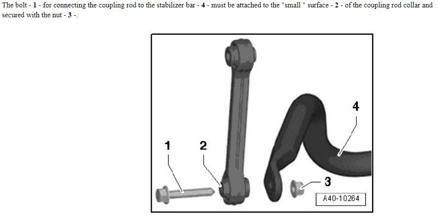

    On the off-chance there is someone else who has to redo a simple little job because they miss something obvious, notice in my pictures how the two bushings aren't identical? See this:
