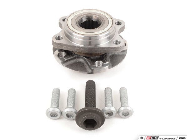

    They bolt on if you you bought a pre-assembeled kit form ECS, however the quality of the bearings in that kit are questionable.
    Here's the assembled kit:

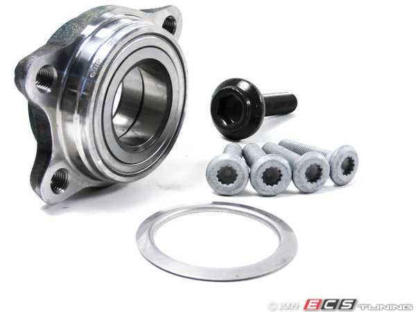

    Otherwise the bearing kit comes like this:
    But the hub still has to be pressed out of the old bearing and into the new one. The bearing and hub assembly bolt up to the knuckle/upright but you still need a good press to disassemble/reassemble the hub/bearing assembly.
