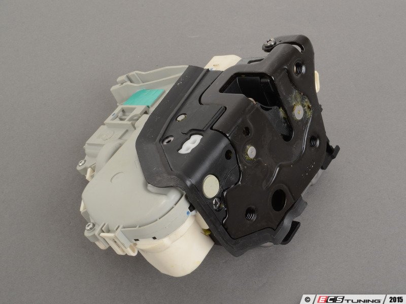

    The actuator is part of the door latch assembly, part number 8J1837015F. If you need to replace it, it's available from europaparts.com for $165.98. It's possible that one of the connectors is not fully seated/making a solid connection, since it will lock, but not unlock. Or some piece of the assembly that handles the unlocking sequence is broken (hence you hear a noise when attempting to unlock, but the actual unlocking sequence never completes). You're probably going to have to get inside the door panel and investigate further.
    Part #17 in the following diagram:
