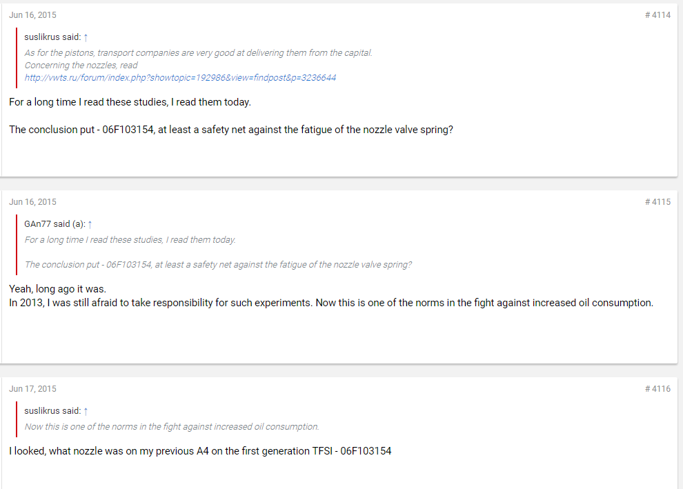

    I know, these are first-gen TFSI ones. Supposed to be better, I read a lot about rebuilds on russian DIY forums and everyone is replacing stock ones with these. Not sure why, since Google Translate isn't perfect.
    upload pictures online
    @casey_tuzziano: I'd just seen your build thread. It's stuff like that that makes want to go on a spending spree.
