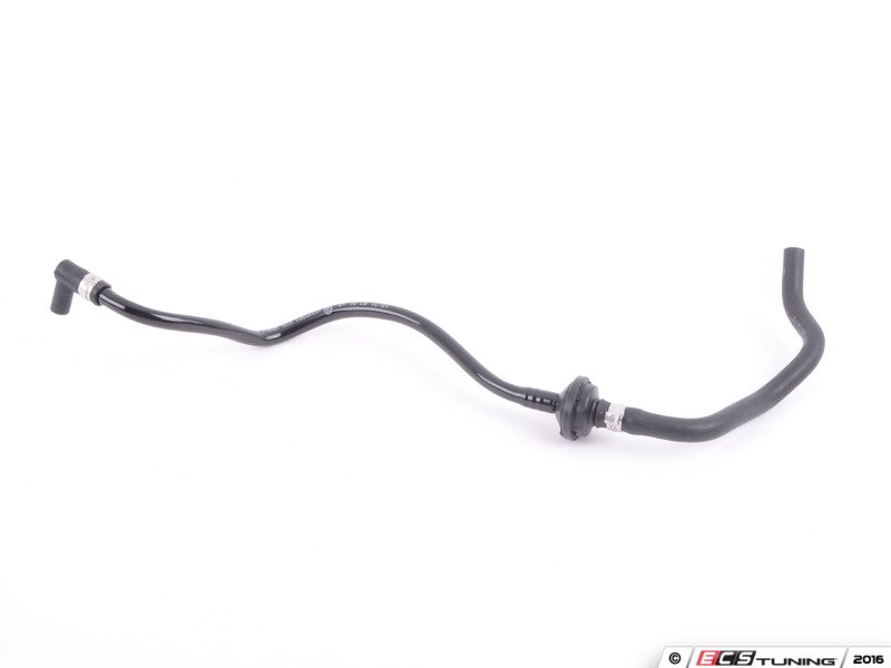

    I replaced the EVAP valve with a brand new OE part from the deal which is this one as well as the breather hose that connects to that valve which has an integrated check valve:
    However the reason I believe it's either the leak detection pump and/or the charcoal canister is because the system on block 070 passes the test when the tank is 1/2-full but the codes come back as the tank gets lower, the hard start after filling up as well as smelling fuel vapors while pumping the gas also remained. However I do not have issues with the pump stopping and fills normally.
