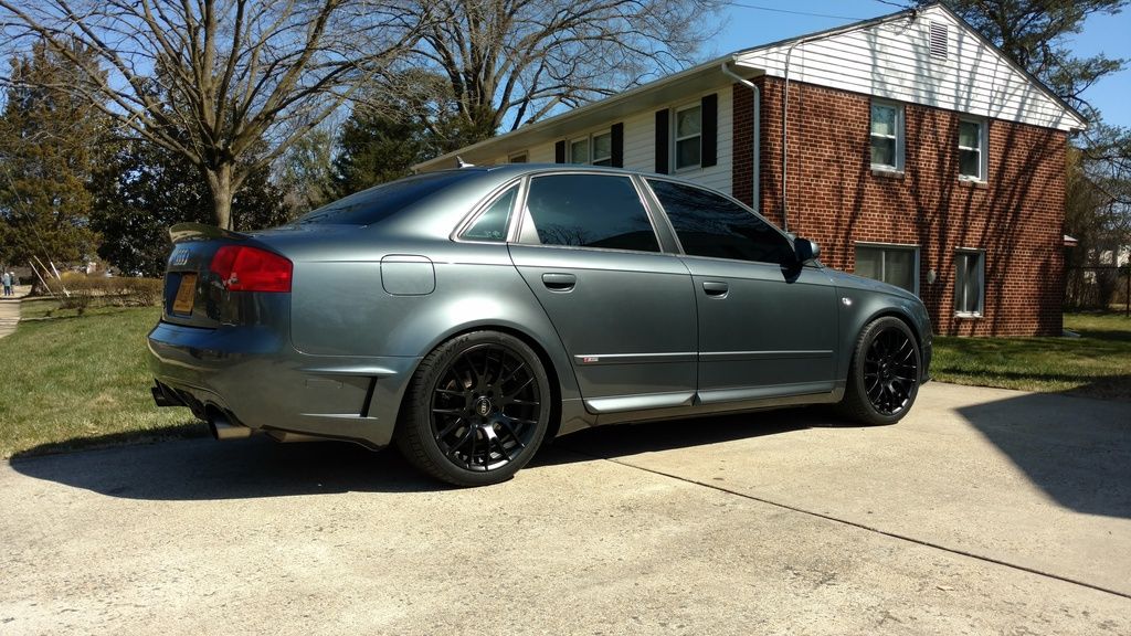

    Vogtland coils set to 25.5 up front and 25.25 in the rear. ET35 wheels, no rubbing whatsoever. Nice ride, stiff in corners, compliant over bumps. Very pleased. Always happy to recommend these coils.
    "I don't understand Audi enthusiasts. They buy a car that looks like a bar of soap, then they spend money modifying it so it looks slightly less like a bar of soap."
