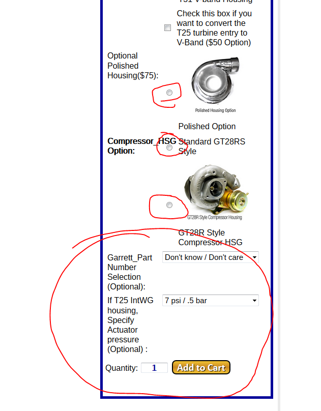

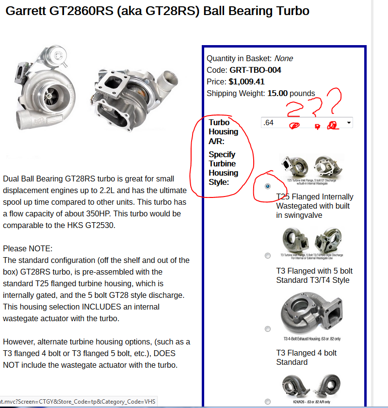

    is this the full frame version of the GTRS? which A/R should i pick as well? i googled a bit a think i found that the turbo APR uses is .64 A/R (i have no idea what AR means tho)
    also, what are these options for?

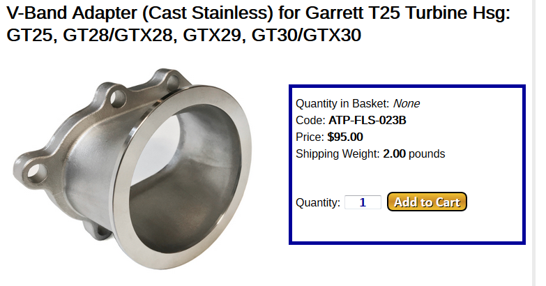

    is this the adapter i would use to mate with my test pipe? it looks like some welding would need to be done as well?
    i just want the same turbo APR uses with the APR manifold and don't want to fuk my order up a second time...TIA!!!

    yes, you want the GR28RS, .64 AR, T25 internal WG, standard GT28RS compressor housing, and 14psi/1 bar actuator pressure. The polished housing option is purely cosmetic, up to you if worth $75 extra.
    That 5-bolt adapter will work, but you'll need to modify your test pipe to have a V-band flage / be the appropriate length (or obtain an APR test pipe/HFC)
