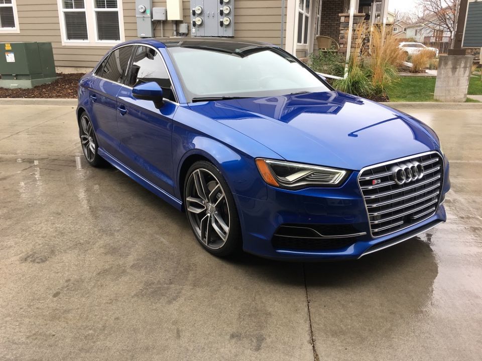

    Here it is in the first week of owning the car. I bought it with around 35K miles on it for a great price. 11/5/17

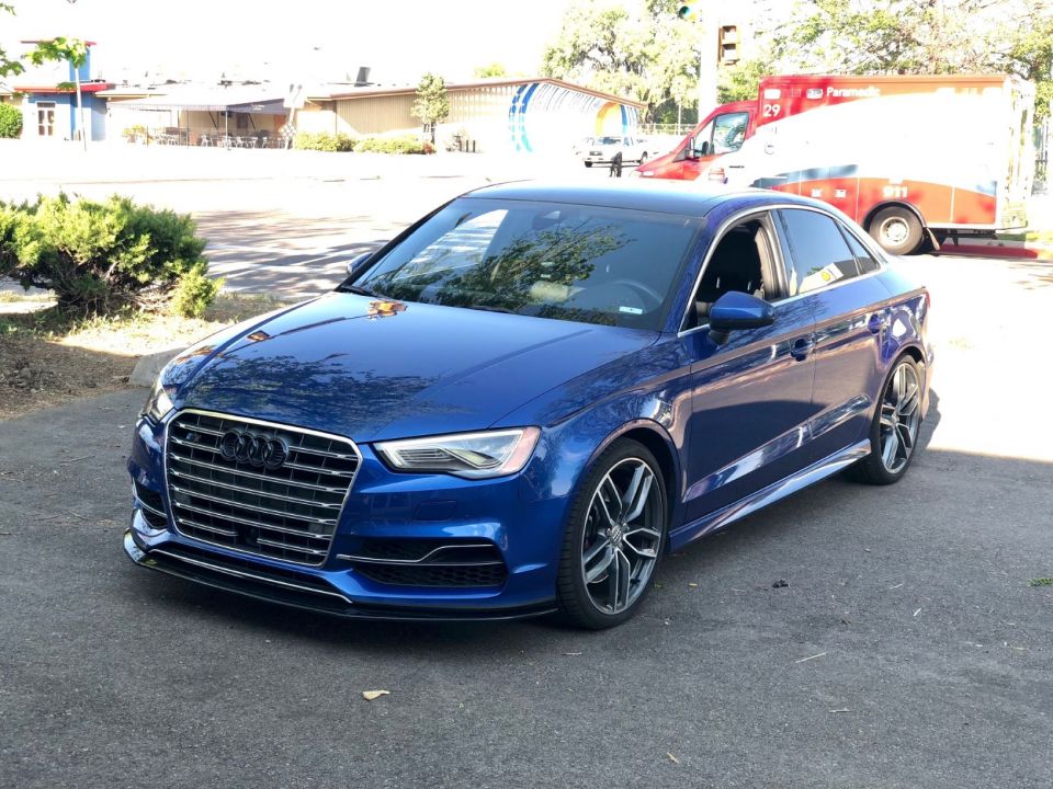

    Recent pic of the front/side 6/15/18

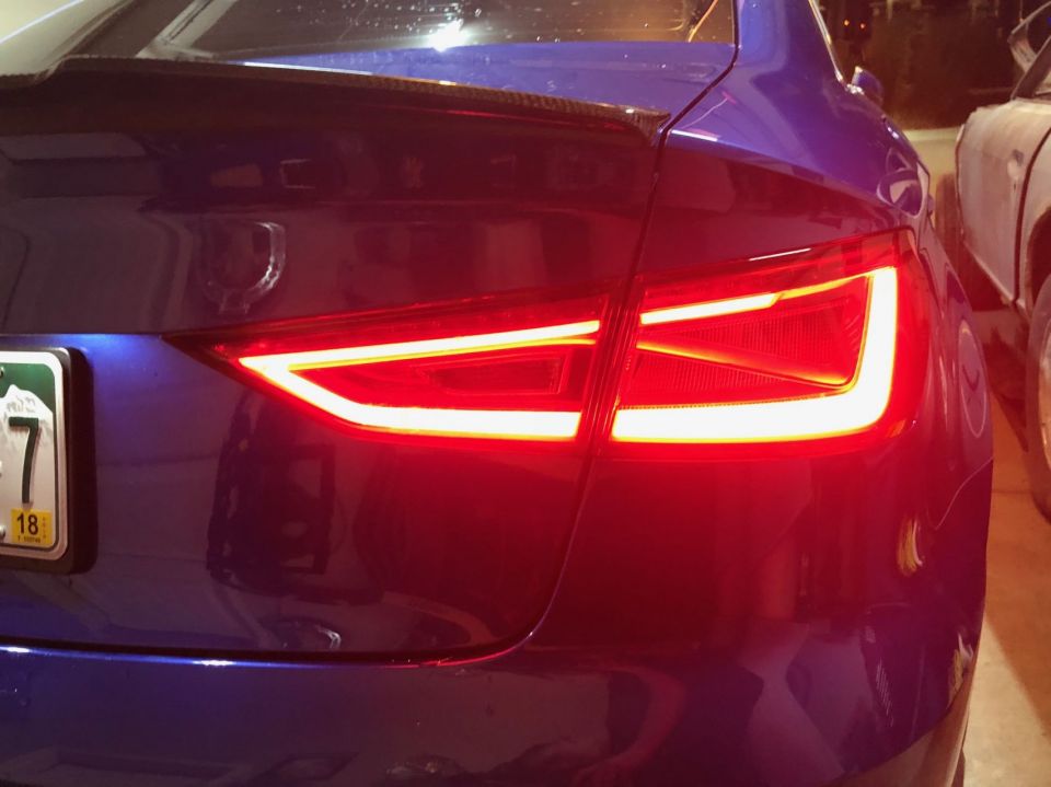

    Tinted my taillights and rear reflectors with Lamin-X "Tint" color 7/20/18
    Before
    After
    Here is a comparison for those curious about light output. One side is tinted, one side is stock.

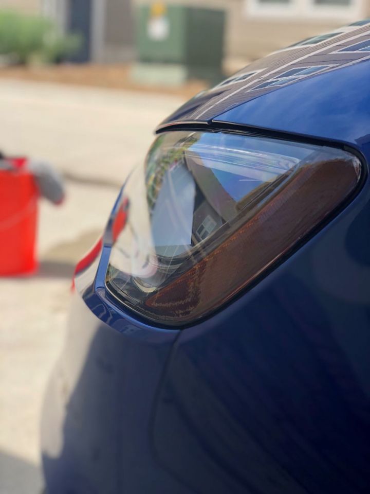

    Also tinted the front side markers with the Lamin-X "Gunsmoke" colored tint. Not as good as E-Codes, but a hell of a lot cheaper!
