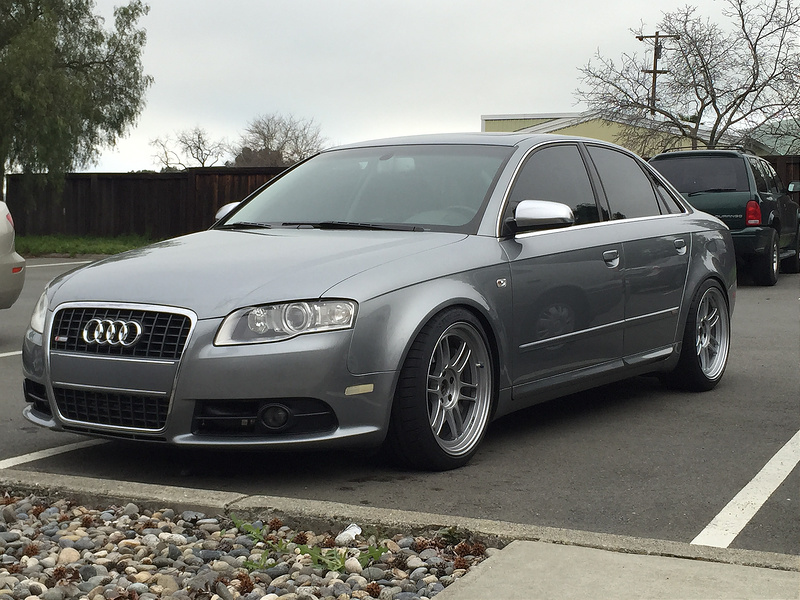

    What size tires are these?
    Assuming the rims in the picture are 18x8, does anyone know (or can you guess) what size tires these are?
    I bought a set of 18x8 RPF1’s but I got the wrong tire size. I got 245/40 and the sidewalls are bulging way out and it looks awful, so Im going to exchange for different tires. If anyone can tell me what size they think are on the car in the picture I would really appreciate it because this is the exact look I’m going for.

    Those are 18x9 +35 part# 3798904435SP
    Tires appear to be 245/35/18 Michelin Pilot Super Sports.
    To get this look on a 18x8 you would want 235/35/18 perhaps even 225/35/18

    235/35/18 Is probably the best way to go.

    If that's the look you want you probably wanna get a 225/40 on those 8s. If you wanted more tire you could do 235/40 (OE spec) but it sounds like you want the 225. I would NOT run a 35 sidewall with a 235 or 225, that's just not the right diameter.

    Thanks for the replies. I ended up going with 235/40 Pilot super sports.
