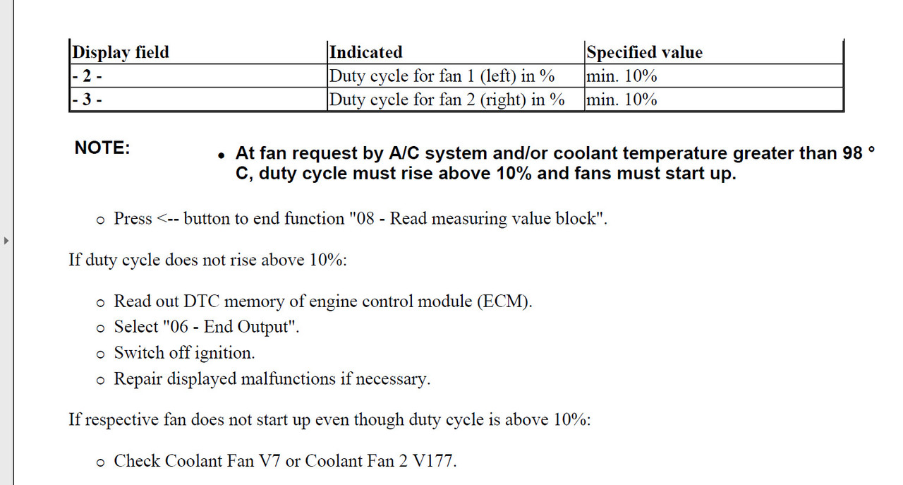

    Maybe this will help you in the right direction:
    So your 9% duty cycle could be a problem
    Also:
    Your 7 voltage could be a problem,
    They say if fan doesn't turn on at 9 volts replace fan.
    if output doesn't reach 9 volts, check/clean wiring to/from control module or replace control module.
    I would first try to figure out why you aren't seeing a minimum of 10% duty cycle and to see what happens if you can get it at 10% duty cycle before replacing anything.
