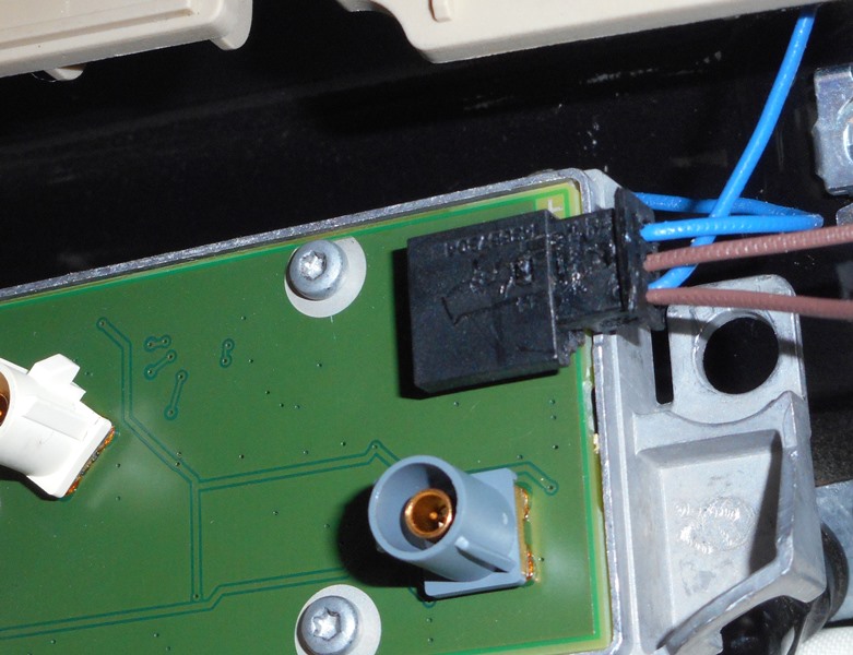

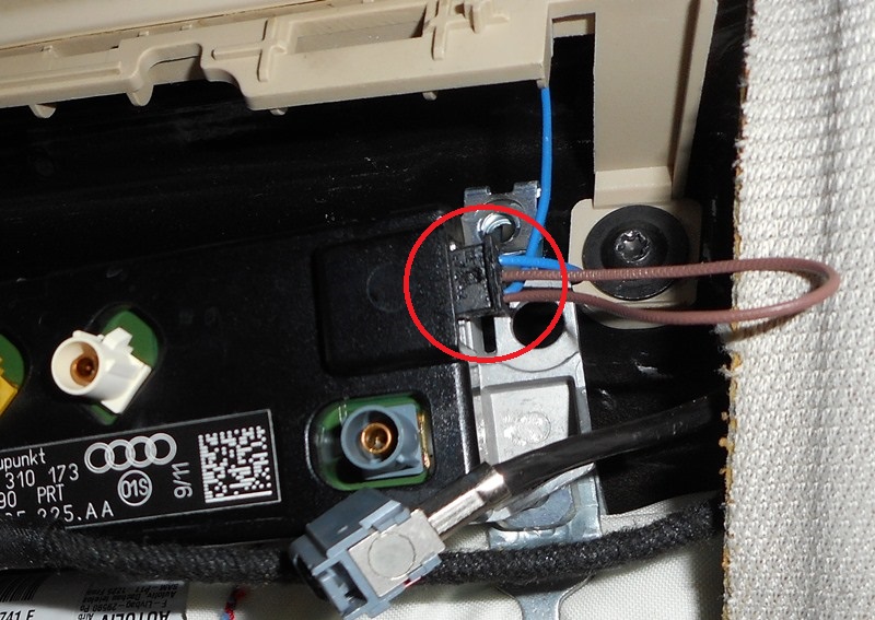

    Local baseball team is on AM radio now. AM antenna is an off and on thing. I'm back at the antenna amplifier in the driver's side D panel and when I push on this plug, AM can come back.
    But, I have NO idea how to unplug this. I worked it so hard I already pulled one of the little blue wires off the glass. I've tried everything. Can't see a latch anywhere.

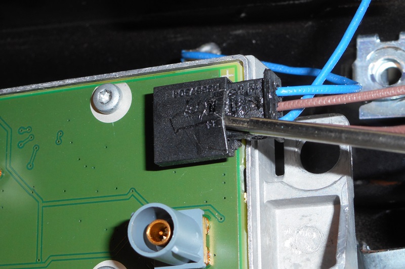

    I appreciate your emotional support Spawne32. But I got smart and pryed that little black plastic cover off the amplifier. Typical Audi small plug design, there's a little catch in that chewed up square hole.
    But now its just laughing at me. I put jeweler's screw driver all the way in there. Damn plug won't budge!!!

    Put it back together (you can't expect me to drive around tomorrow without FM radio or GPS like some damn settler in a covered wagon) and it all works. If I push on that plug, I get AM.

    For all you guys who are waiting breathlessly for the end of this story......
    1. Found out my reception is solved when I push on/flex the circuit board in this antenna amp.
    2. I unbolted the amp, made a cut in the female end of that plug joint and got the plug out.
    3. Can't blame Audi. I think the problem is the male plug on this aftermarket window glass.
