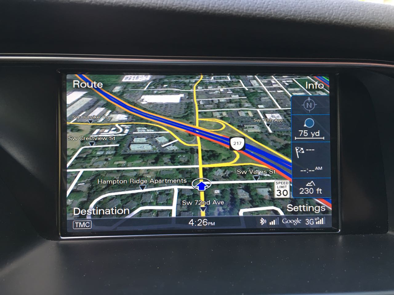

    So, got it working...
    Long story short, I was finally able to get 3G connectivity (via AT&T/FreedomPop) in my 2013 Allroad. It required a UMTS capable modem (AT&T frequencies) from a 2014+ MMI 3G+ unit and the driver update package only obtainable from the Audi dealer (more on that at end of post).

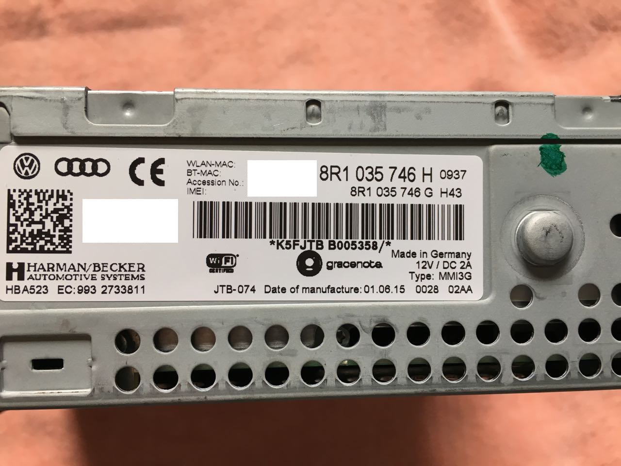

    Quick primer on how I got there. My 2013 MMI unit has a part number of 8R1 035 746 C (build date of 5/7/13), found on right side. First, I got the newer modem from a later MMI 3G+ unit (part #8R1 035 746 H, build date 6/1/15). 2014 or later build dates should be fine, but the "UMTS" text on new modem is key.

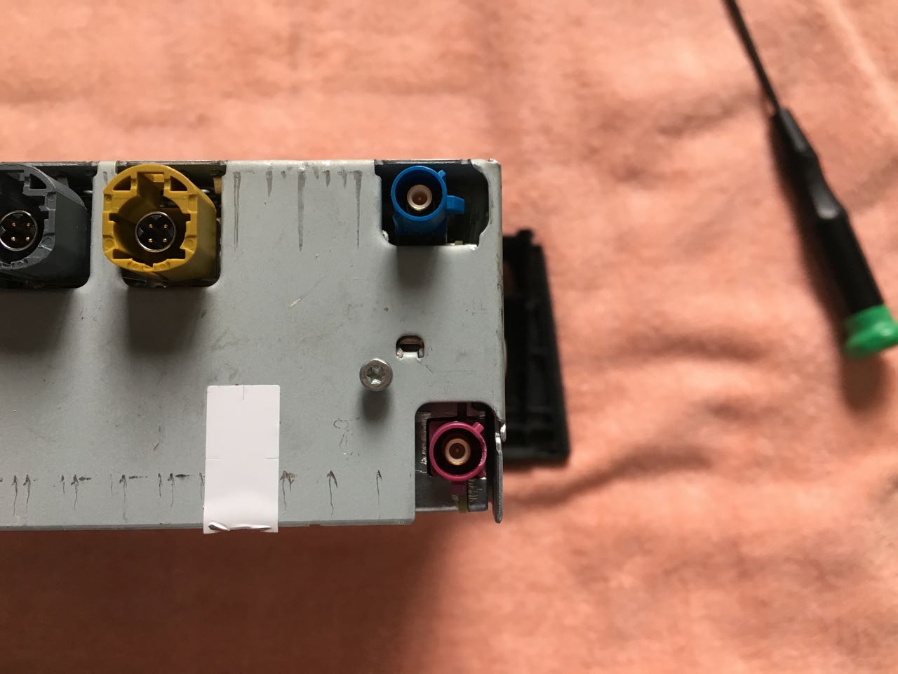

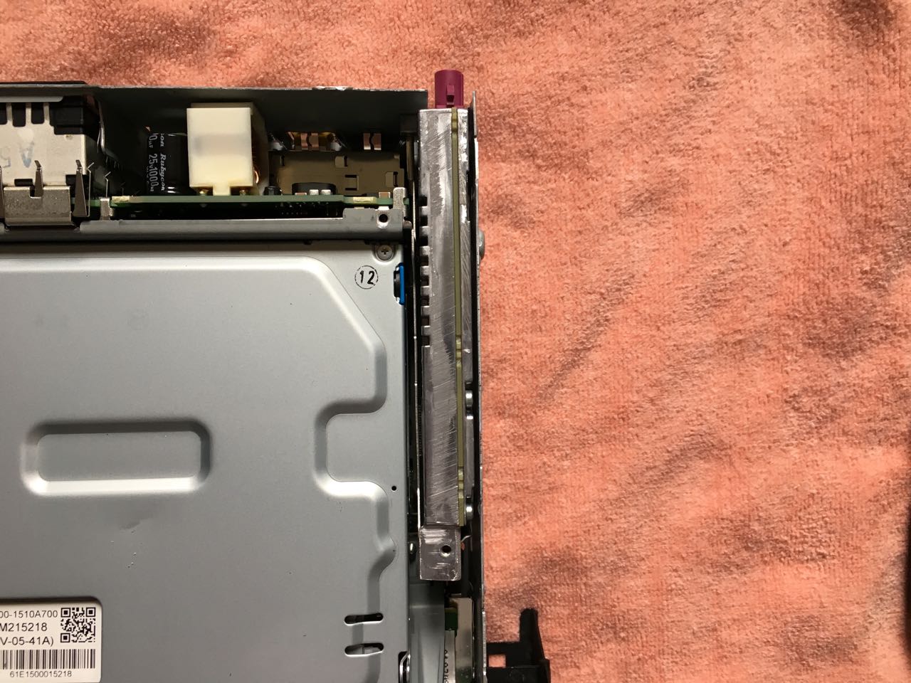

    Using a T8 Torx, I removed the top 7 screws and 1 back screw (to remove the top and free the modem). Looking down, it is in the top right corner with the magenta color jack.
    With the back side Torx out, the modem pulls straight up to remove.

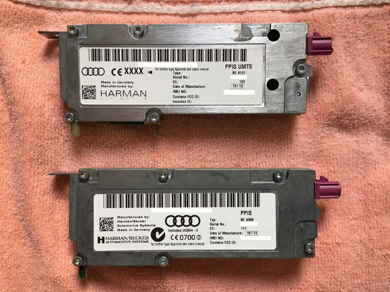

    The newer AT&T modem is on top (note added "UMTS" text on label), the older T-Mobile only is on bottom.
    Installation is the reverse of removal. There is a pin on the bottom of the modem to help guide it into place, push straight down to seat. Replace the top and all screws and reinstall unit into car.

    Was this factory K version(MMI unit on label is which version?)-as you said in first post or after update was K? As K is new and not Telit inside but other company module
    Retrofits: FL taillights / MMI 3G & 3G+(Street view incl.)/ Color Cluster & FL S5 Cluster/ BiXenon/ ADS Lite
    Other: ECU Tune/ VCDS Tweaks/ FL Gearknob/ Soundproofing/ Interior 6D Carbon Wrap/ Rieger Rep Front Bumper Valance/ Basic sound(8) upgrade to "ASS"(9+1) + B/O Sub(in sidepanel)/Tweeters + Activsub/ Efficiency Prog via Cluster & Gateway flash/ Sideskirts/ Window Tint/ Wsp Peeler reps/ License plate & Interior leds
    Junior Member One Ring krisuumax's Avatar
    Oct 21 2019
    523269
    S4 8W
    Poland
    unit 8R1 035 746 K. Module new installed Telit UC864-E
    Veteran Member Four Rings Gunnark100's Avatar
    Oct 21 2012
    102672
    Earth...
    Quote Originally Posted by krisuumax View Post
    Interesting, factory K should be 2016 and inside must be Cinterion not Telit, at least this Lukasz has inside with same year.

    Unit is a North America, factory module remove, new is EU TELIT.
