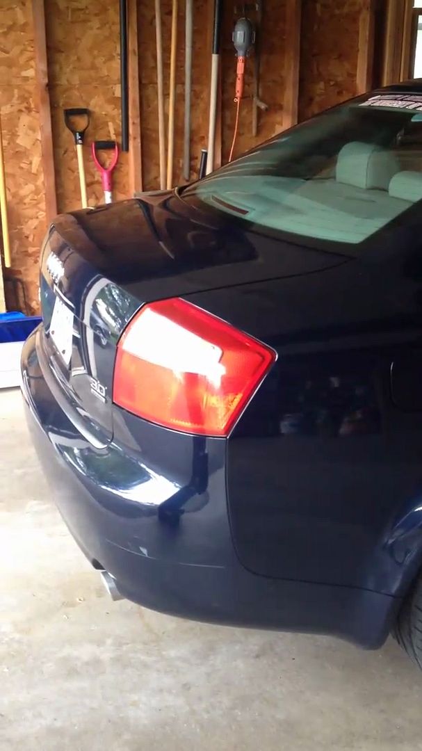

    Jetta mk5 hinges and gas struts. Re-drill one hole and it bolts right up.
    [IMG][/IMG]

    Quote Originally Posted by deyrag View Post
    [IMG][/IMG]
    is re-drilling that hole necessary? can you leave it un bolted or does it hinder the function of the trunk? im kinda hesitant to drill into the trunk lid
    turbocharge all the things
    Jan 09 2012
    86404
    MA
    Quote Originally Posted by nicktheblasian View Post
    i left that bolt out and just used 2 of the 3 that attach the hinge to the fender. Hinge to trunk lid matches up perfectly

    Parts you need if using B7 parts
    2x 4F5827665A (Springs)
    2x 8E5827552K (Struts - different gas pressure to std struts)
    8E5827302H (Right hinge)
    8E5827301H (Left hinge)
    or just search fleabay for Jetta mk5 hinges and gas shocks. the key to the auto open is the little springs on there and the higher pressures gas shocks.
    https://www.ebay.com/itm/Trunk-Hinge...VX88pE&vxp=mtr
