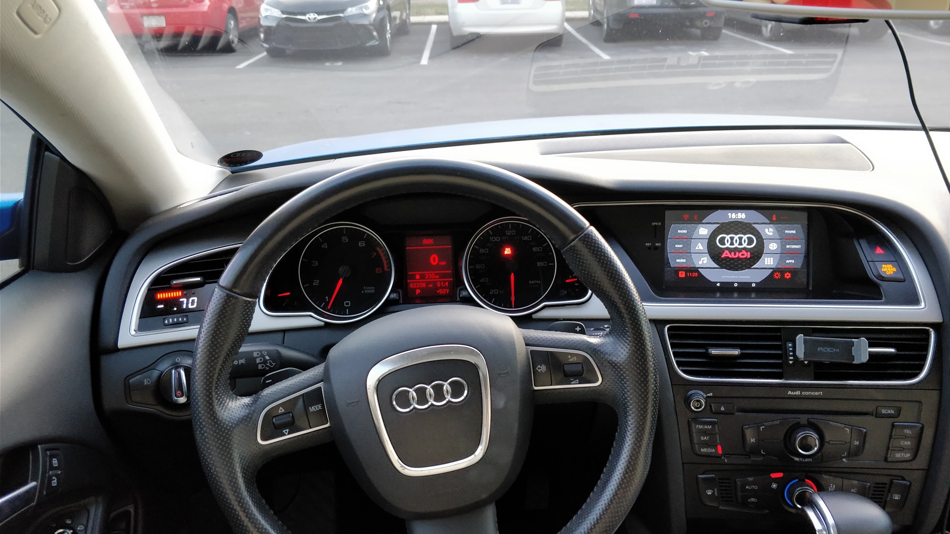

    Quote Originally Posted by a4android View Post
    It seems aftermarket to me, but that's really good. I think that's sony CCD judging from Hue.
    It is the camera that is sold with the units on rsnav website.

    Quote Originally Posted by risu View Post
    Oh... I didn't know that....
    I am going to ask the supplier if he updated the imaging sensor because the one installed in my car isn't good as that one.
