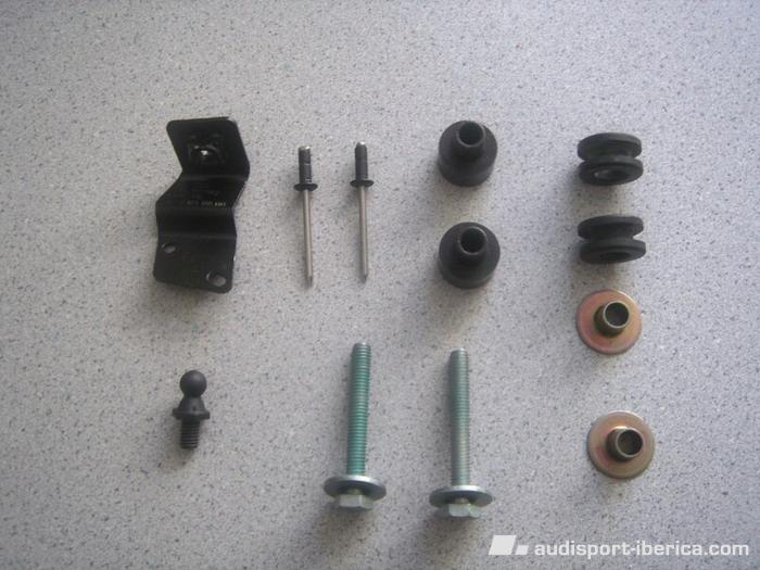

    Wow, that's absolutely fantastic, thanks for that. I ran out to check the radiator support, and the rivet holes for the bracket were even there already. An image search for that bracket led me to this photo as well which shows all of the parts that you've quoted, as well as their quantities:

    I only used one of everything, except for the rivets, which you need two of. The ball goes at the back and the grommet/bushing/bolt/distance piece etc. goes at the front. There is another attachment hole on the side nearest the fender, which might be where the other set of "two of everything" goes. I didn't fit that to mine as the quantities listed on the parts catalog I looked at I think was one each. If you find that the other set does go on the side, let me know and I'll get that fitted on the wife's car too.
