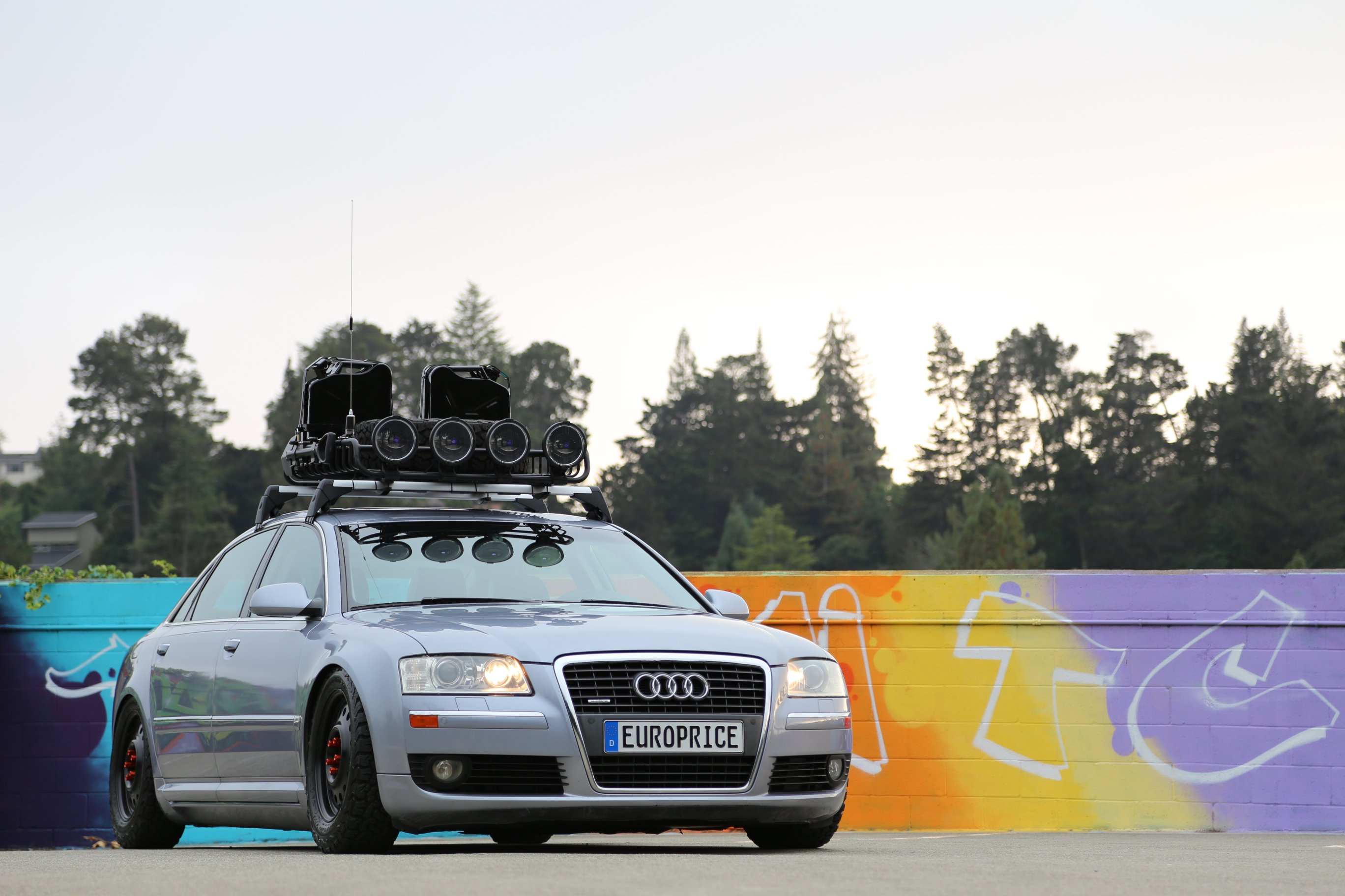

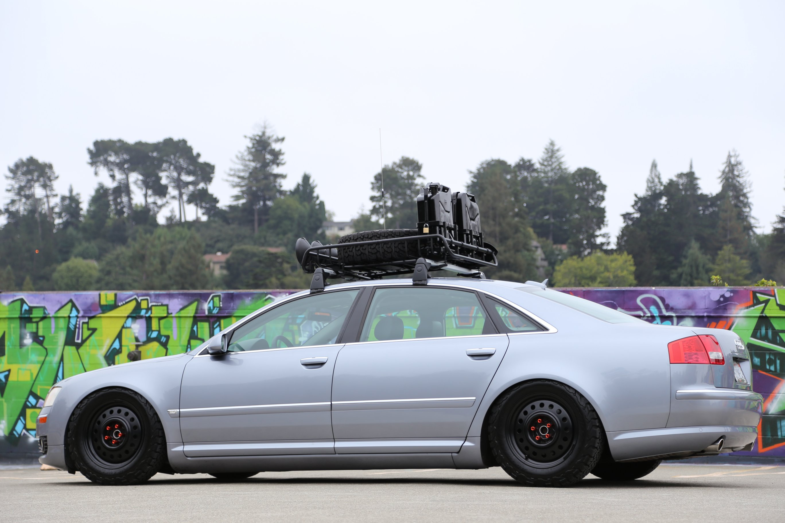

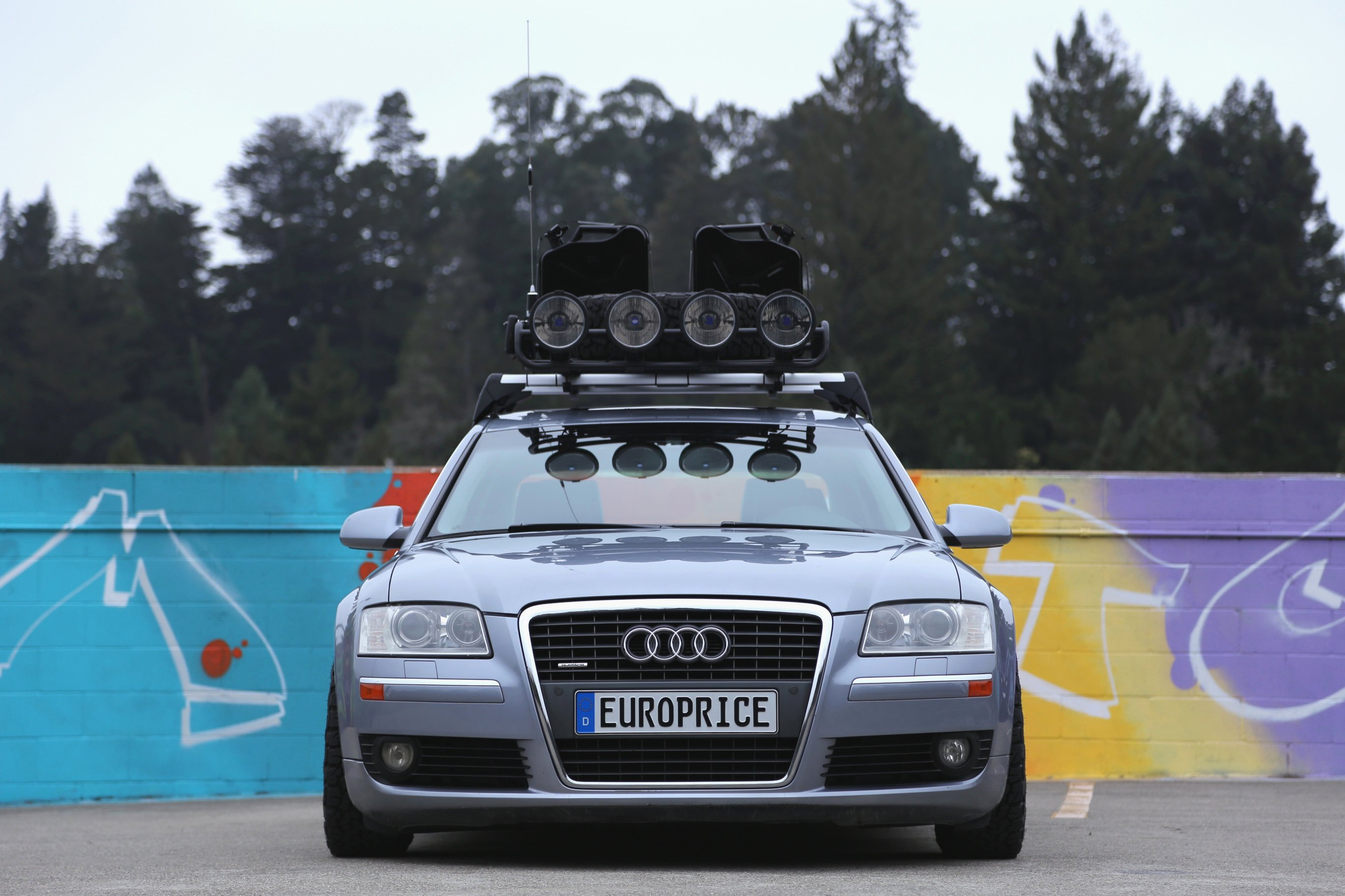

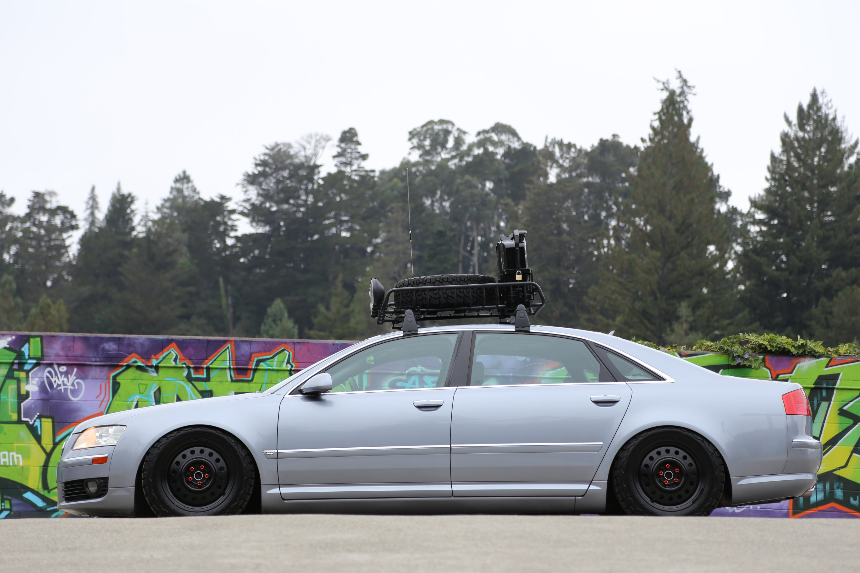

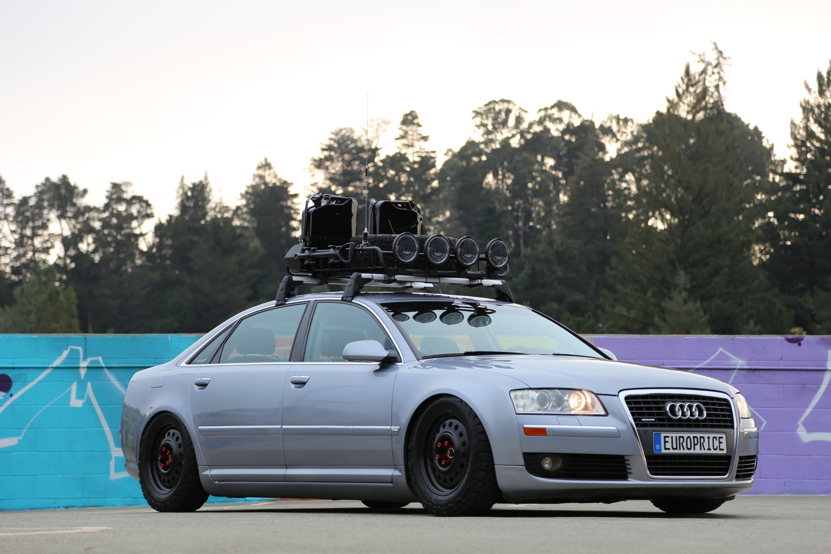

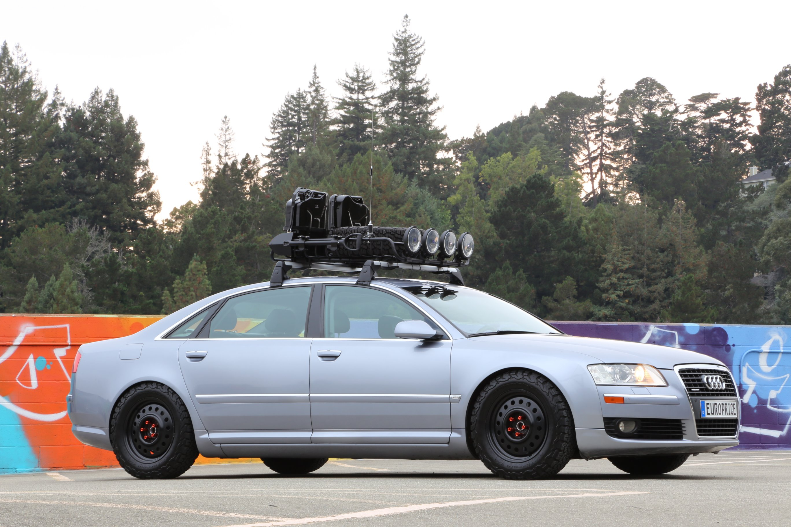

    Sometimes ideas come from the least expected places and as ridiculous as they sound on paper they just have to be set in motion...
    During the first test outing with Gorman Motorsports pro-class naturally aspirated Polaris RZR we found that we ran out of space inside the tow vehicle for all of the supplies and team members to all get into the desert. Well as luck would have it the A8 D3 has air suspension and a lift mode, so why not give it a shot. The car performed amazingly well on dirt, loose gravel and deep sand, even with less than capable performance all-season tires.
    The idea was borne that every race driver needs a limousine back and forth from the event, but even better yet a limo that can turn on a dime, deliver a mechanic or needed spare parts and roll through the desert in air conditioned ease.
    The seed was planted and the inevitable just had to happen. After some research on the biggest tire diameters possible, some test fitments and months of gathering parts the slow build up process yielded this, enjoy!
    The car features a host of useful upgrades that any chase vehicle for an offroad team would need. A custom installed CETE air suspension controller allows for the fun of -55mm front and rear for parking and 30mm of additional clearance in lift mode which is still fully switchable through the factory MMI. Hella lamps were custom wired up with dual relays and wired to the factory front fog light switch with a hidden cutoff just in case we don't want to blind anyone while using the fog lights normally. Factory Audi crossbars hold a Loadwarrior rack with a full sized spare, additional gas, a shovel for any sticky situations and a 5ft VHF/UHF antenna for longer range team communications. The car is fully stocked with hand tools, power tools, jump pack, air compressor, emergency equipment, first aid kit and plenty of space for mechanics, driver's and spares in the unlikely event the car becomes the primary chase vehicle during it's first race 8/18 for the BITD Vegas to Reno race.
    Lighting
    4x Hella Rallye 1000 Black Magic Lamps
    Lamin-X Fog Light Film (Incoming)
    Exterior
    European License Plate Holder
    Genuine Audi Crossbars
    Yakima Loadwarrior Rack
    Yakima Spare Carrier
    Yakima Shovel Holder
    2x 5 Gallon Jerry Cans
    3M Clear Bra
    Interior
    S-Line Post-Facelift Flat-Bottom Steering Wheel Package
    S8 D3 Shift Knob
    Electronics
    CETE Air Suspension Controller (Custom Installation)
    Suakoi 600A Jump Pack and Air Compressor
    Boafeng BF-F8HP 8W Dual Band Radio
    Tram 5ft Whip Antenna Directly Wired to Handheld Radio in Console
    6x USB Outlets and 5x Cigarette Style Outlets
    Wheels and Tires
    Pacer 17x7" Black Steel Wheels
    BFGoodrich 225/65-17 T/A K02 Tires
    H&R DRA 30mm Spacers
    56mm Hardened Wheel Studs
    Aerospeed Aluminum 21mm Lug Nuts
    Supplies and Tools
    10 Gallons of Gas
    Full Sized Spare
    Bully Tools Short Shovel
    Full Hand and Power Tool Kit
    If you are an offroad racing fan or just want to see an A8 well out of it's element, or maybe this is it's element, don't hesitate to follow both instagram feeds here starting Wednesday 8/16 forwards with the main event being 8/18 at 9AM PST when we begin chasing Gorman Motorsports RZR in their quest to finish this grueling 540 mile race:
    Europrice.us - - - - Gorman Motorsports
    If all goes well next year you'll see this #offroadaudi in Baja, Mexico...
    Cheers!
