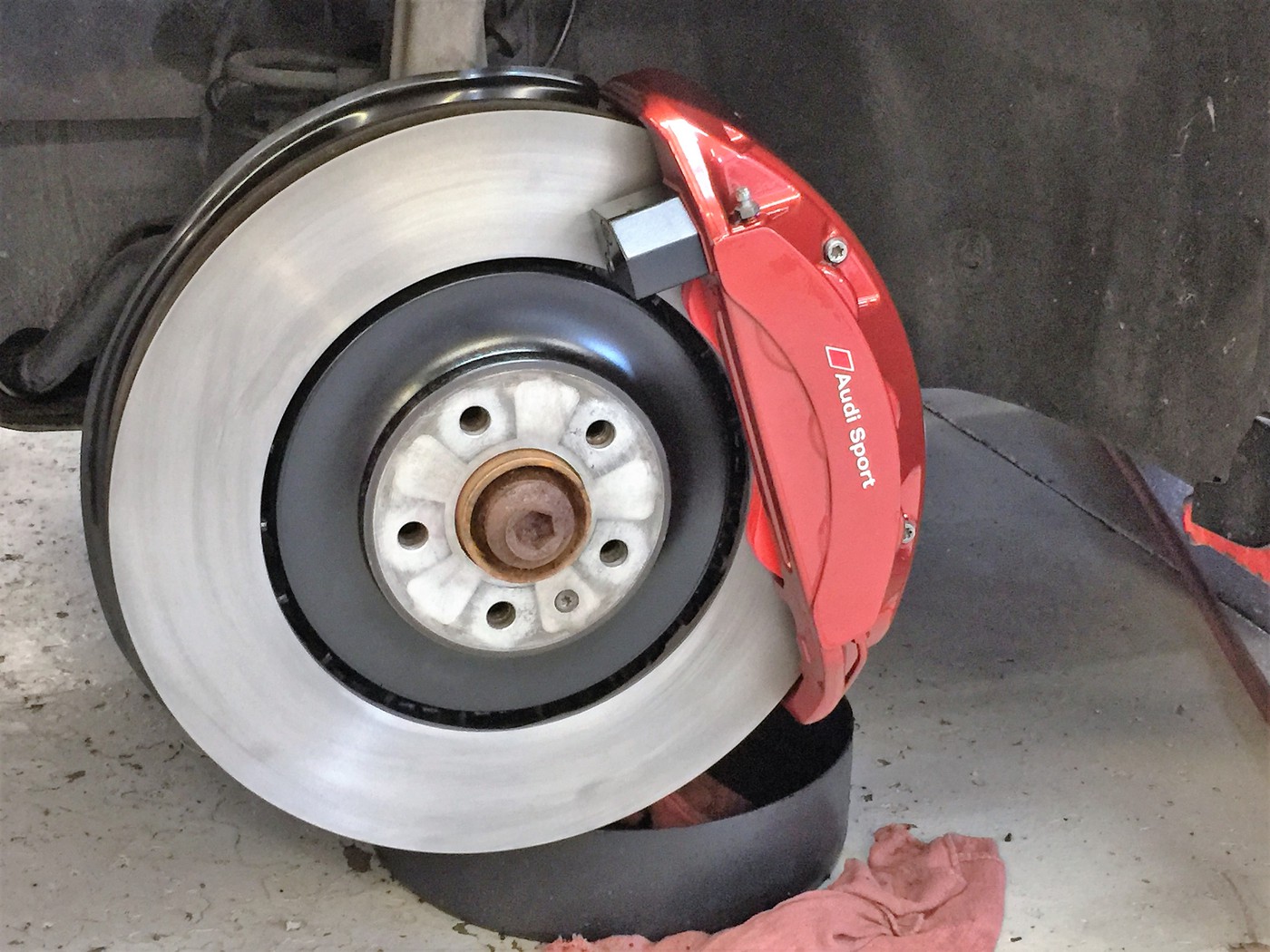

    Yes, they do. Plug n' Play, however as stated in the above threads, the calipers and rotors are "HUGE!" When searching for wheels, use the S7 as the model, to be sure the wheel clears the calipers. The best part is, the Stopping Power is AWSOME! With the additional HP and Torque from the Stage II 3.0 it's nice to have some additional stopping power. Many have complained about noisy stops, rusty rotor hats, and dusty pads. I had my hats painted with chassis paint and went with EBC "redstuff" pads with very good results

    Quote Originally Posted by A6sport View Post
    Where did you get those decals?

    Quote Originally Posted by Street Nasty View Post
    Sent from my LG-LS993 using Audizine mobile app
    https://www.amazon.com/s/ref=nb_sb_n...rt+brake+decal

    Thanks! They look awesome on your car.

    Thanks for the tip, the calipers look good!!
