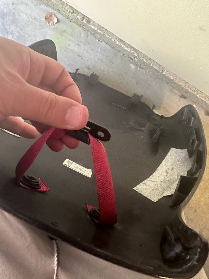

    I finally got the carbon seatbacks and dash caps installed! They were CF skinned/laminated by Exotic Car Gear in PA - Very good work! Thank you for the recommendation, @Mops@Nemisis.
    I scooped up a brand new seatback from GenuineAudiParts on a clearance sale, and picked up the other from Ebay for around ~$100. The used seatback had a cut retention strap - Apparently, this is common on used seatbacks as the clip that attaches the retention strip to the seat chassis is a bit of a pain to navigate. Lots of salvage yards will cut the strap for easier removal without understanding the parts' significance. Exotic Car Gear also replaced the cut strap on the used seatback - Good as new, now!
    Said retention strap - This strap prevents the seatback from becoming a projectile in the event that the seat airbag deploys - IMPORTANT STUFF!!!
    For disassembly/removal of the seatback, I've found it significantly easier to remove the two torx screws that fasten the retention-strap clip to the seat chassis. Remove the two torx screws, then remove the seatback from the vehicle with the clip still attached to the strap. It's significantly easier to remove the clip from the strap once the seatback is removed from the vehicle.
    They look great! I did wait a few weeks to install them. Prior to install, I did a quick ISO wipe down, then installed Gtechniq CSL and EVOv4 coatings to keep them fresh.
    My only concern here in sunny Northern California - My rear seat passengers will need to wear sunglasses due to the glare off of the now glossy seatbacks. Fun fact though, no one ever rides in the backseat of this car!
    I scooped up some used dash caps from Ebay for around $50 for the pair. The CF skinner/laminator do have to remove some of the ears/tabs to get the weave to lay flat during the process. However, they reattached them with epoxy after completion of the lamination and they fit perfectly!
    Some observations - The factory seatbacks flex quite a bit. This makes them easier to install/remove. When the seatbacks are skinned/laminated with the CF, they are obviously more rigid, which can lend them to becoming a bit more difficult to install. Take your time, and you'll be happy with the results.
    I've got some more things cooking. Stay tuned!
