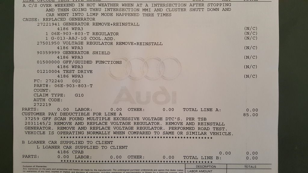

    Sounds like the issue I had with over voltage. The dealer replaced the voltage regulator. There's actually a TSB for this, 2031145/2. It seems to be a common enough issue to issue a TSB and the same voltage regulator is used across most of the model line (A4, A5, A6, A7, Q5, Q7). Interestingly enough it doesn't explicitly list the S4 but the symptoms are the exactly the same. Maybe they don't list the 'S' variants and just fall under the 'A' line. Here's the repair order:
    So far it hasn't reoccurred. Here's the TSB: http://www.esghotwire.com/bulletins/...TC_Present.pdf

    Like most of you said it was the voltage regulator that was the issue. I took it to another Audi dealership that works on a lot more S and RS cars. The pricks at the previous dealership changed out my relays and battery instead of regulator. Now granted my extended warranty covered me for the regulator, I still paid 500 for the relays and programming. I've been yelling at them since because I just paid for something I might have not even needed because of their sub par diagnostics skills. I asked for the voltage read outs when they checked the relays and they said they tried to obtain it but ultimately it didn't save so they don't have it.... How convenient. I'm done with Audi of Peoria in AZ
