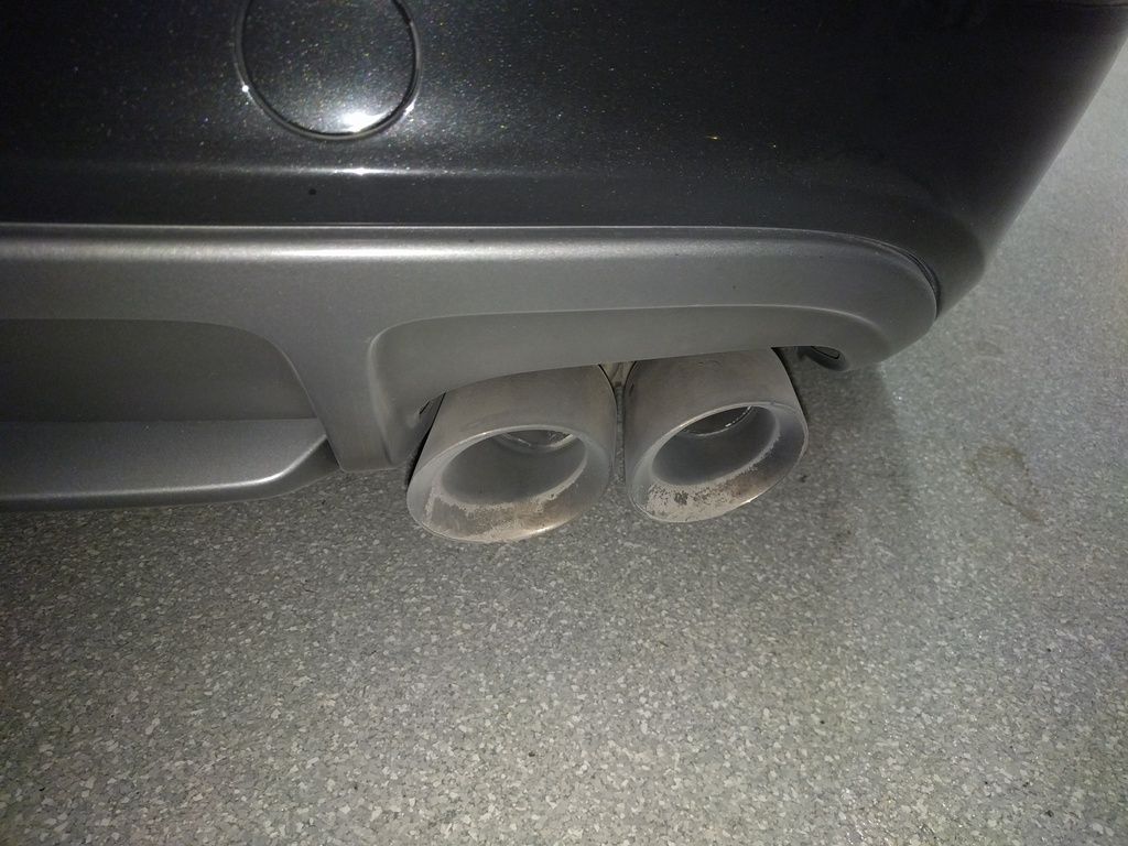

Over the weekend during a grocery store run, I had noticed that the tone of my Corsa exhaust sounded a bit different. It was much deeper than normal. At first I chalked it up to maybe a loose exhaust clamp and that i would tighten it up later on when I got home, but when I stepped out my vehicle I noticed a very strong smell of gas very similar to my STI with a catless exhaust. At this point I still chalked it up to a possible exhaust leak and thought nothing more of it.

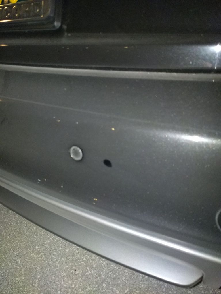

But on my way home, the CEL pops on in my dash. I pull in to my garage and immediately pull the code via VCDS and im getting a P0420 Catalyst System Efficiency Below Threshold (Bank 1) error. I also notice that the rear of the vehicle and exhaust is covered in a layer of white/grey metallic dust.
The car was washed and clean prior to going to the grocery store. Here is what it looked like after a 20 mile round trip:
I did a quick search and all of my symptoms point to a failed/blown cat. I understand that the catalytic converters on our vehicles are covered for 8 years/80k miles. Problem is, my car is fairly modified, as I am currently running a stg 2 tune. If Audi is willing to replace the cat's under warranty that would be awesome, but I fully understand that you have to pay to play, and I am more than willing to pay up to get new cats installed at the dealership or at my local tuner shop. What I want to get down to is why this is happening, and what we can do to prevent it from happening to others.
