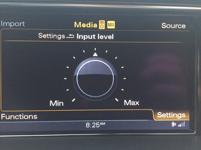

    Try to have iPhone 4/4s ...one more thing :before you're going to compare make sure that you have the same setting for SD Card and "iPhone" sources.
    Question for you...in MMI, what do you have the input signal dial set at for the Iphone through the AMI cable? If I leave it a zero, the output level is way lower than the SD Card. At first listen, there is definitely an improvement in audio quality, will need to load up a bunch of music to test this out.

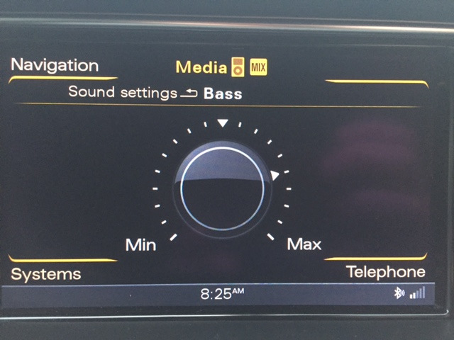

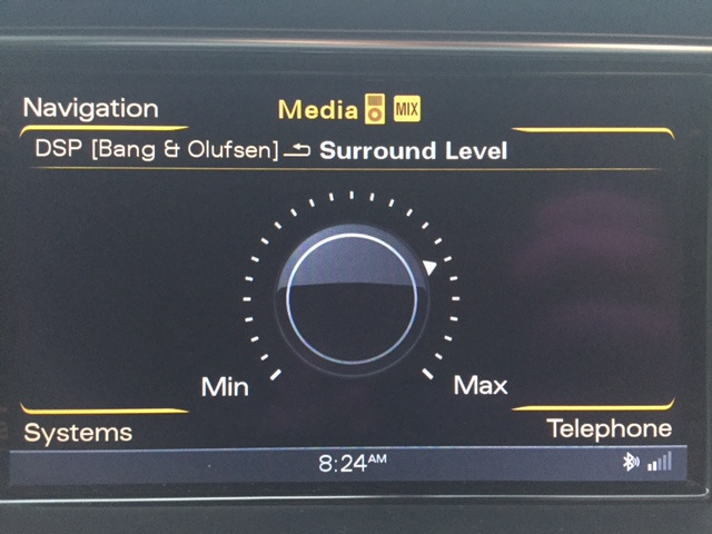

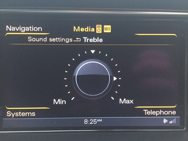

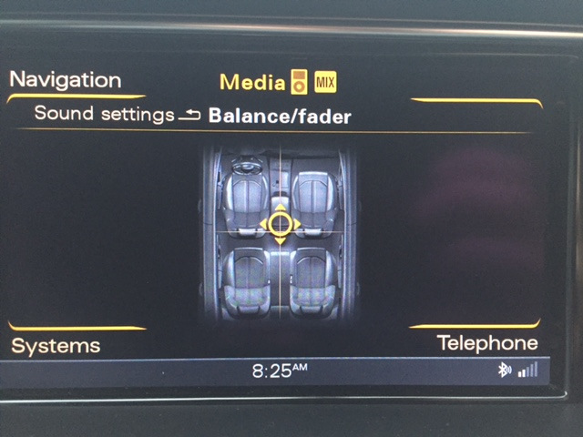

    Quote Originally Posted by fmzip View Post
    I told you :))) Now I have a question for you too. B&O is well balanced system with + and - , and I'm frick of SQ as you...So , now when you're running from better audio source (as well try some original CD) how the sub sounds?! Isn't ahead of MF and HF ?!
    Here are mine settings :
    2013 Audi S5 3.0T: Custom Audison with B&O, Quattro Sport Differential, ADS, 7-speed dual-clutch DL501
