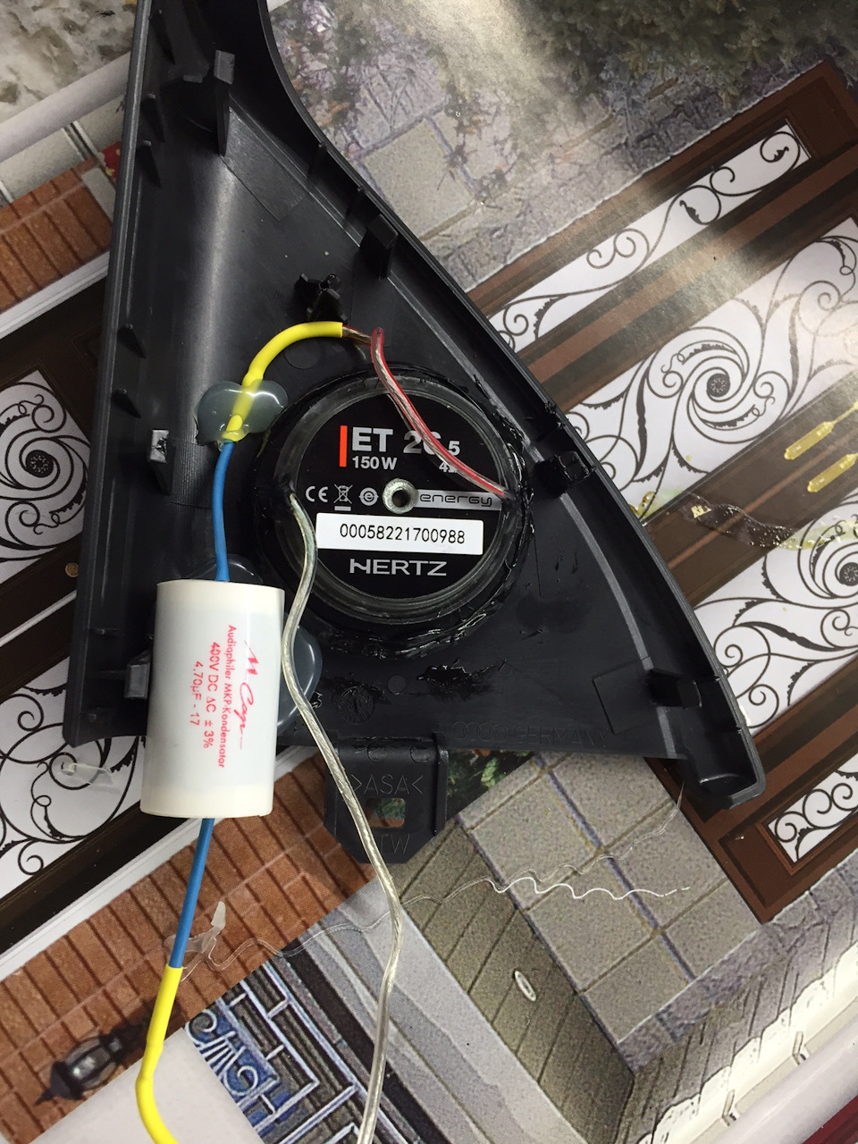

    You can use together with Audison Prima AP8 Hertz ET 26.5.
