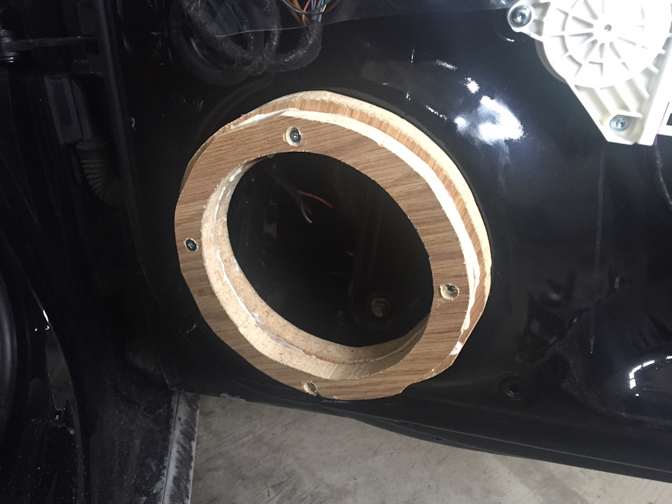

    Does anyone make 3d printed or otherwise custom adapters for the AP8s or something similar that would work?
    Sent from my SM-G955U using Audizine mobile app
    Feb 12 2017
    393090
    Redmond, WA
    Quote Originally Posted by techracer View Post
    Anyone?
    Veteran Member Three Rings Strong Man's Avatar
    Jan 24 2017
    391521
    Anyone?
    I don't understand why you're looking for 3-d printer etc. Two peaces of wood, wood glue, Jigsaw and 30 minutes of the job . That's all what you need.

    Sounds like you're on your own. That kind of thing really wouldn't get enough volume to make the project worth it, and people would just complain if they were $99.
    Time to grab your router and circle jig!

    Router, circle jig and some plastic. Done in a couple hours.

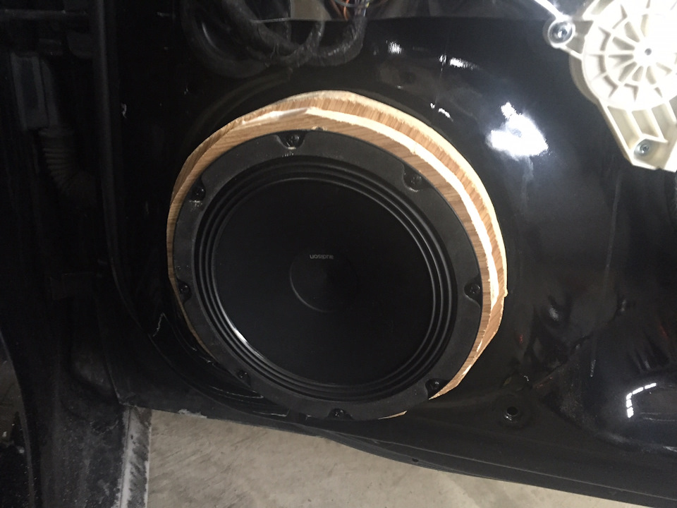

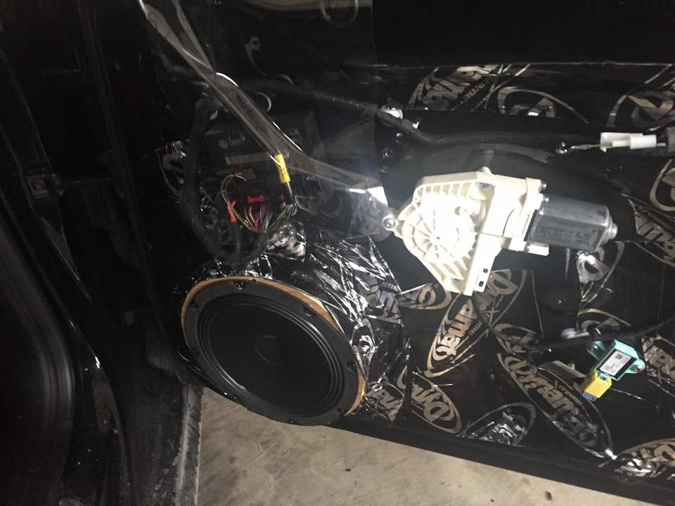

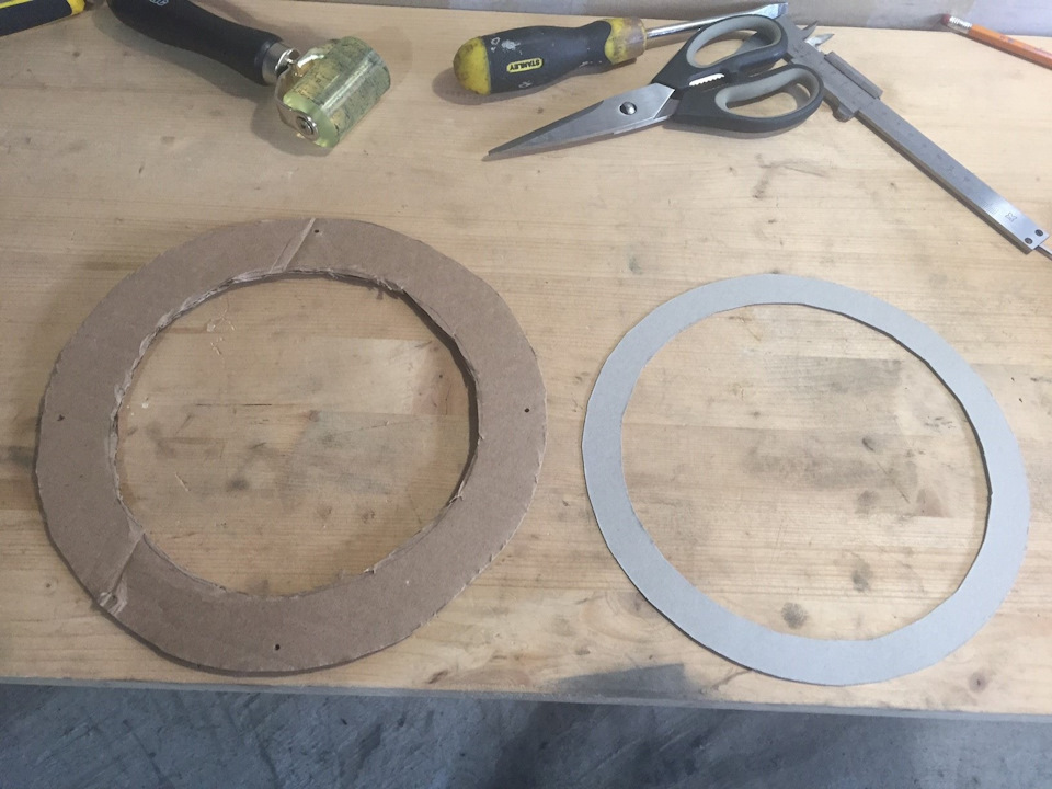

    I got it from a local plastics supplier. I forget what it is called but think of cutting board plastics, that's what it is made of. (it's NOT ABS or Acrylic) I made a template out of 1/4" MDF, then used that to cut the plastics with the router. The plastic is made up of two pieces, one 1/4" and one 1" piece. Because of the type of plastic it is, it needs to be screwed together, glue won't hold it. If you do this with a router, be slow with the depth. The 1" piece I had to take multiple passes around as the bit was trying to take to take chunks out of it if I tried to take too much off on a single pass. Take your time and it's easy to do a good job.
    I used plastic, since MDF will get wet, (it's inside a door) and it will swell and ruin over time. The plastic will not deteriorate.
    Follow my build on IG - https://www.instagram.com/AlterdA4
    Integrated Engineering (Sport Short Block | Sport Head Assy | Intake Manifold w 4 x 890cc Injectors), BW EFR8474 Turbo, Custom 4.5" FMIC, Custom 3.5" SS Turbo back Exhaust, Tilton Racing Twin Disc clutch/PP & LWFW, 034 Billet Motor Mounts, AP Racing BBK 380(F)/330(R) floating rotors
    Veteran Member Four Rings fmzip's Avatar
    Aug 21 2017
    405420
    Quote Originally Posted by cybernet99 View Post
    Nice work!
