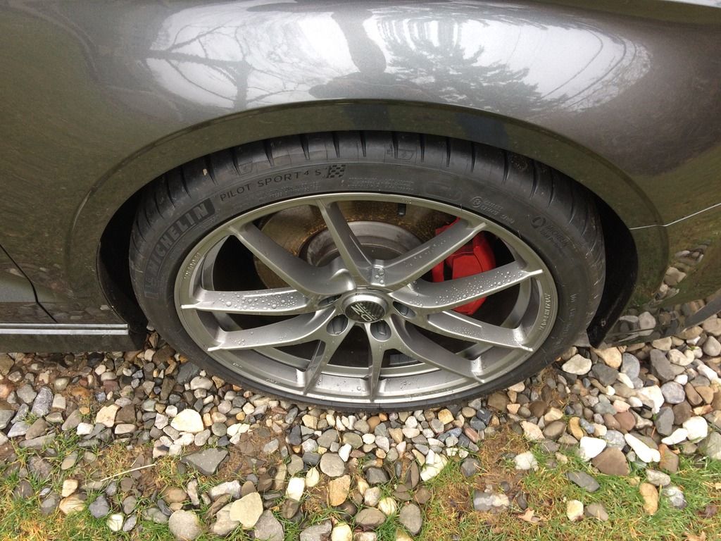

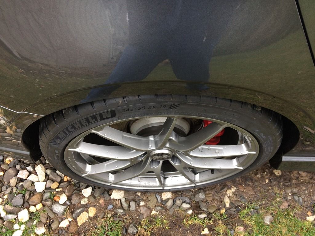

    Decided I didn't want to spend a silly amount of money twice a year to have my summer tires swapped over to winters on my stock wheels, especially when the techs typically grossly overtorque the lugs using the airgun. So I've got winters on my stock wheels and picked up an OZ/Michelin summer package from TireRack. Put them on the other day and happy so far. Went with the more aggressive offset (ET38) on 8.5" wide Leggera HLTs. Chose slightly wider 245/35-19 in the new Michelin Pilot Sport 4S. No rubbing so far, even with 034 Motorsport lowering springs installed. Thanks to threads on this board for the guidance in sizing. So one more data point that shows 245/35-19 on 19x8.5 ET38 works well on a lowered S3.

    Love it! Especially the specs. Loved my 8.5 CH-R with 245. Please post more pics.

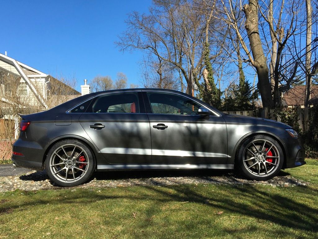

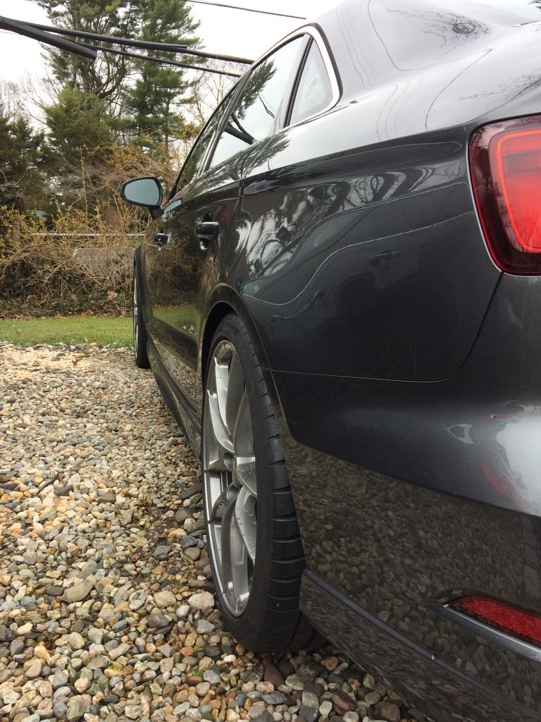

    Any shots along the side of the car to show the stance?

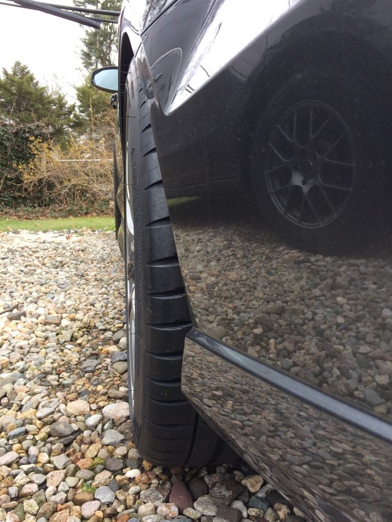

    As requested, more pics.
    Side view, back to front:

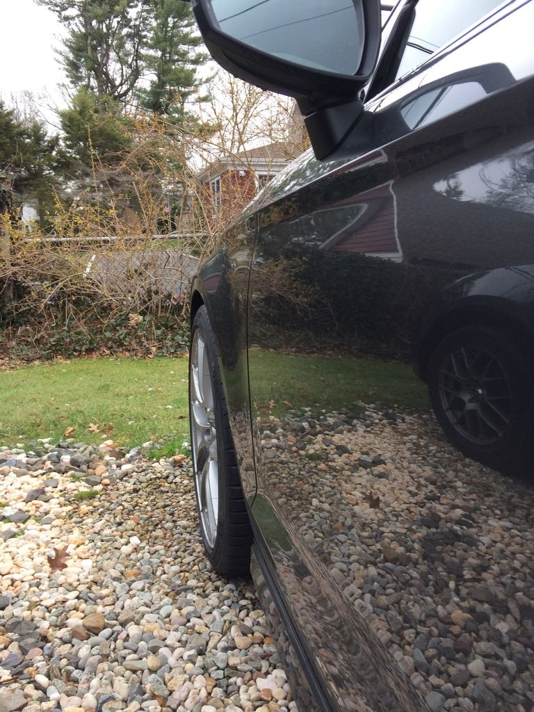

    Front to back:

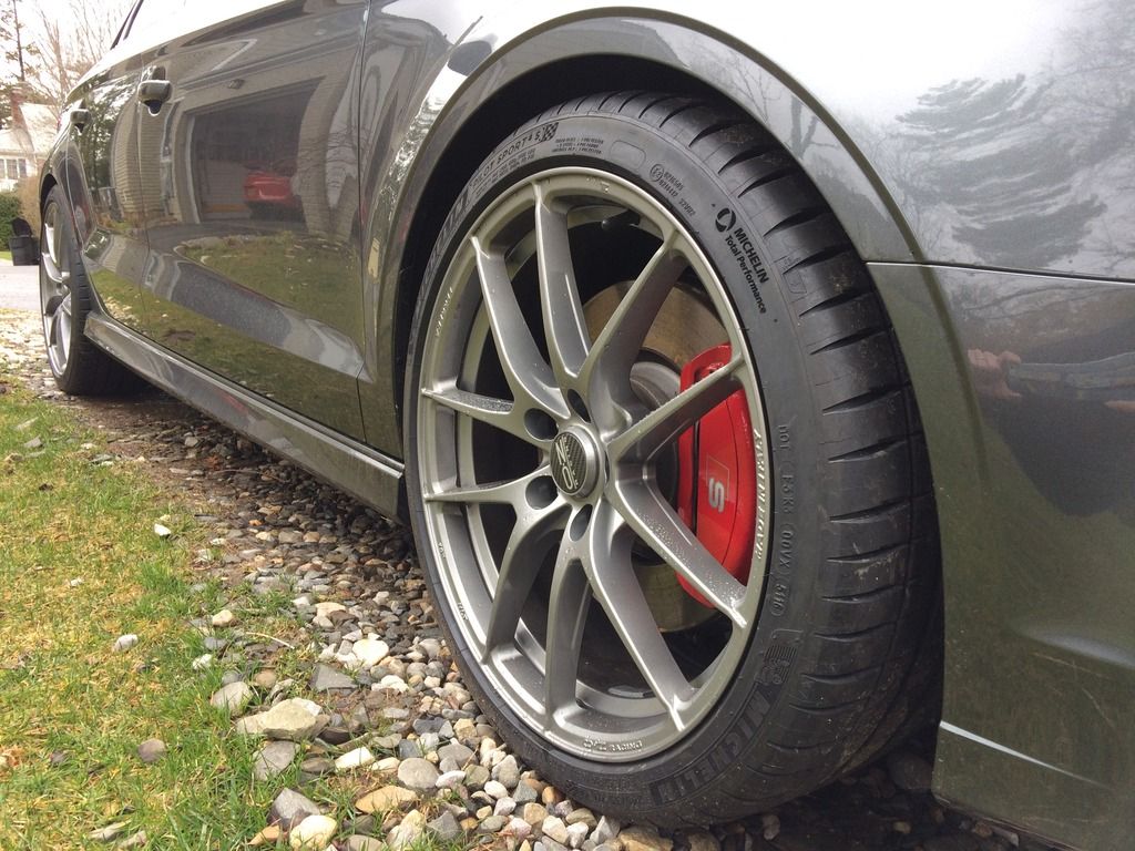

    Front closeup, showing degree of flushness:

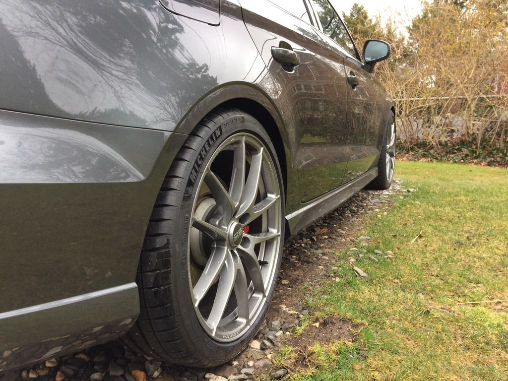

    Rear closeup:
    Pardon the rusty brake rotors. The weather here has been miserable and I haven't driven the car today.

    That looks about as perfect as can be. Great choice!
