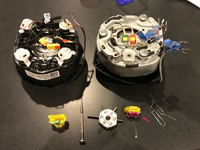

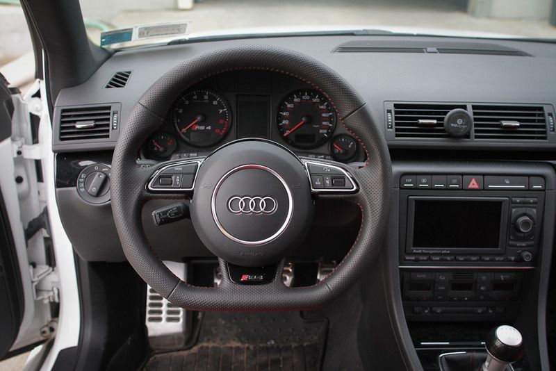

    One of my biggest pet peeves on this car.. the wimpy stock steering wheel. I finally took the plunge. I purchased this from another forum member, thanks to FATBREMBOS.

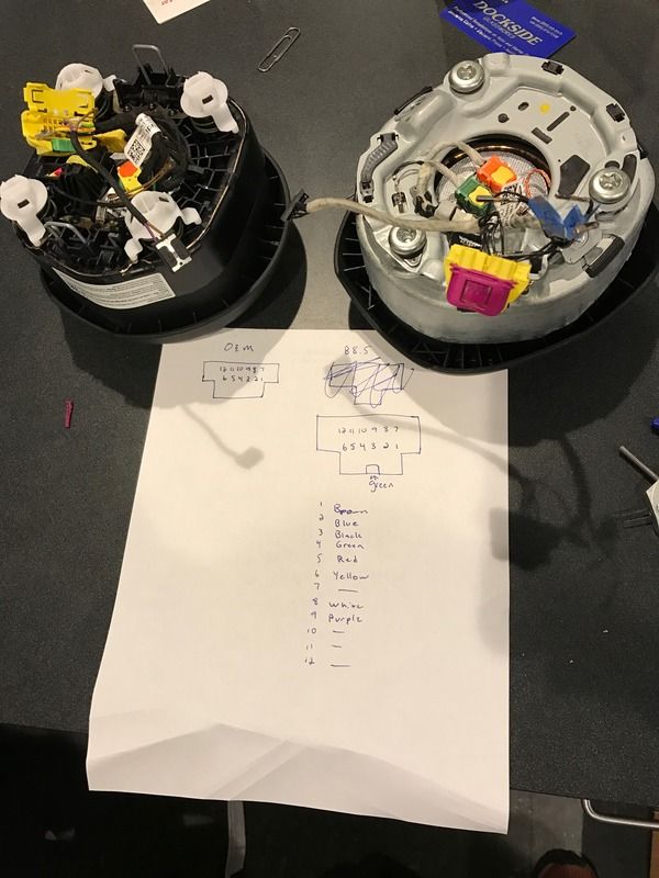

    The install was not bad after figuring out what needed to be re-pinned. AJACKSA4 was a huge help in guiding me into the right direction. So I wanted show some more detailed pics for anyone else doing this install.
    Some tips
    - Be very careful when de pinning, when you use the tool to unclip the wire it should just pretty much slide out without any resistance. I used a combination of the depinning tool and paper clips and needle.
    - To make the new steering wheel work in the rs4 simply swapping the yellow connectors. All wires stay in the same locations, so you need to reuse the yellow connector with the purple side clip.
    - I think the main bolt that holds the steering wheel down is torqued to 50nm, I didn't get a new bolt just some loctite.
    I just absolutely love this mod, takes a little getting used to the flat bottom. The red stitching matches perfect my red and black leather. The controls also work as normal.

    Look great!

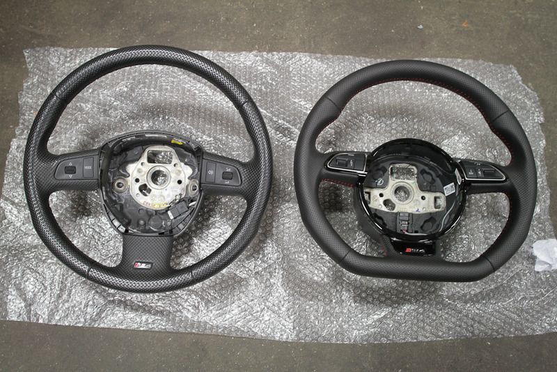

    What car was this wheel originally from? Looks great!

    Looks great man!!
    Such a big difference compared to the stock wheel

    This is a factory rs4 b8.5 steering wheel. You can have them ordered without paddles. If anyone is interested just send me a dm

    This might a stupid question, but if you need to re-use the yellow connector with the purple side clip from the original B7 RS4 wheel/airbag on the b8.5 wheel/airbag to make it work with the B7 RS4 then does the B7 RS4 wheel/airbag become useless?
    If so, is it possible to just buy the yellow connector with the purple side clip (the one from B7 rs4 wheel/airbag) at the dealer or somewhere online? Anyone have a part number?
    Aug 30 2009
    47090
    Long Island
    Good question, there were part numbers on the clip but I didn't look for them. This would be a lot easier then needing to de pin both clips.
    I would just swap the clip if I turn back to stock.
