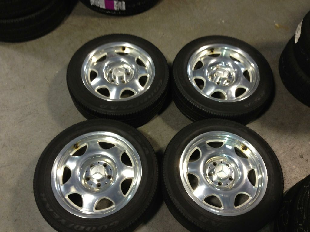

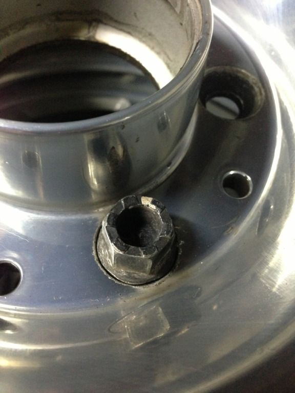

    My new drag wheels

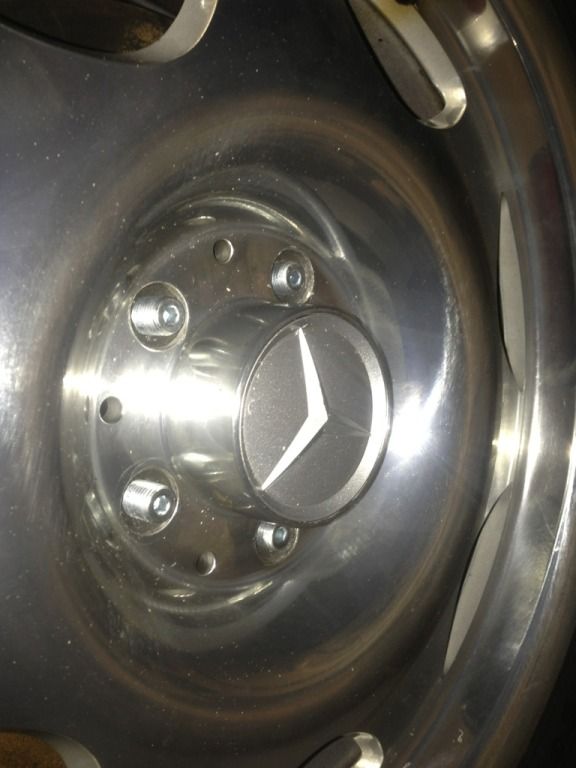

    CLK 320 Wheels 16x7 ET37 ~14lbs each.
    Had to do a bit a of modifying to the lug holes but nothing crazy.
    Test fit on my boys S4, didn't clear his brakes. I'm running 332mm Stoptech front BBK so I'll need spacers (thinking 8-10mm), also ordered wheel studs from Mike at Ringer-Racing.com
    These Hoosiers caught my eye so these will get ordered this week, 225/50/16.

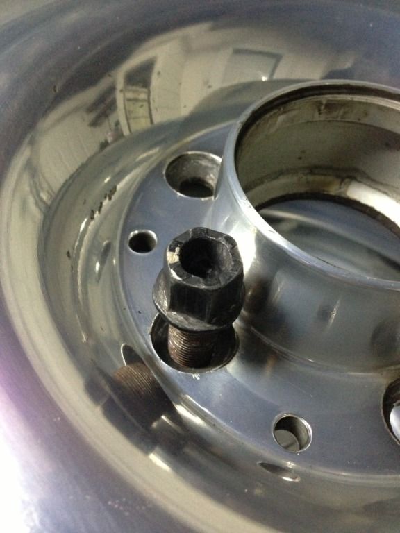

    My new drag wheels

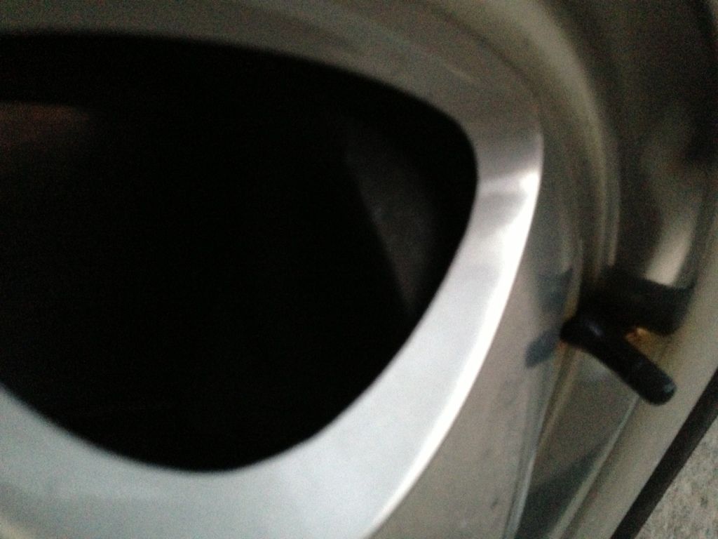

    Yes, the S4 rotors are 320mm stock and there was room to play. Here's the best pic I have.

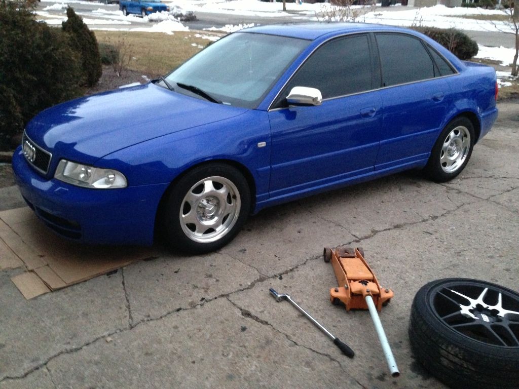

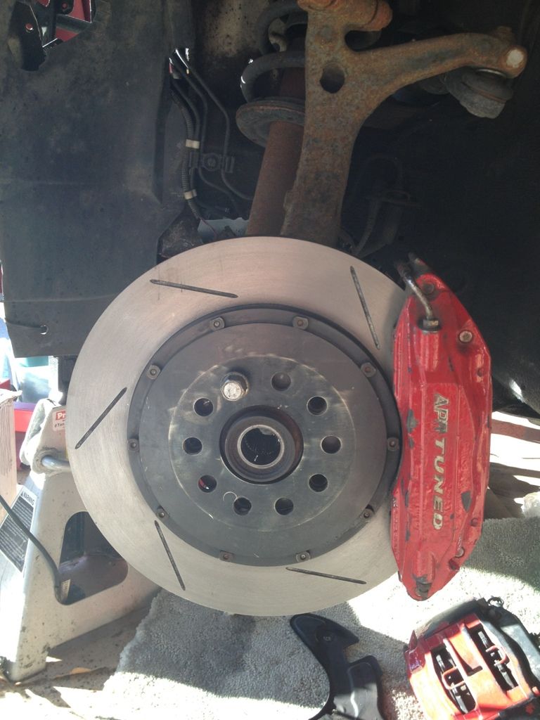

    I'll see how they look this weekend, don't mind the surface rust haven't touched my suspension yet.

    What about the caliper clearing the barrel?
    Jun 10 2010
    60106
    I think it's going to be a tight fit (if they fit).
    I just went to check my brake + wheel setup and there is less than an inch between the caliper and the wheel barrel. Assuming my 17" wheels would have a barrel size of 17" and your 16" wheels have a 16" barrel, I don't think they'll fit.
    I have 993tt calipers on 330mm rotor fwiw.
    I know the brake calipers aren't the same.

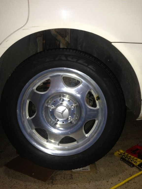

    Yes they will clear with a spacer.

    Yea, I have the driver side BBK on but not the passenger side. I tried to put the wheel on the car put my stupid rotor kept falling down so I put the wheel face down and mocked up the brake setup inside the wheel. There's a lip where the caliper hits but I think with a 10mm spacer it will clear fine.
    I will have the wheel mocked up on the car this weekend with spacers that I'll borrow from a friend to determine how big I'll need. I don't want to run anything over 10mm as I simply don't trust spacers but idk we will see. 10mm should do it no problem though.

    Quote Originally Posted by Turbo Nerd View Post
    is that just a test fit? that caliper is on the wrong side/upside down.....
    Veteran Member Four Rings Turbo Nerd's Avatar
    May 12 2009
    42386
    B5 A4, B5 S4, C5 Allroad, C5 A6
    Detroit Metro Area
    My new drag wheels
    Just bolted up

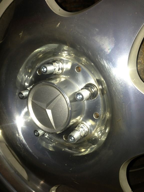

    Mounted on the rear, boy are these light.

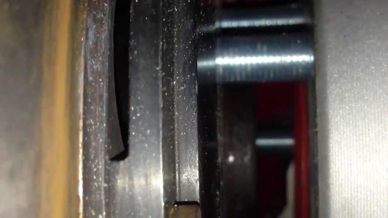

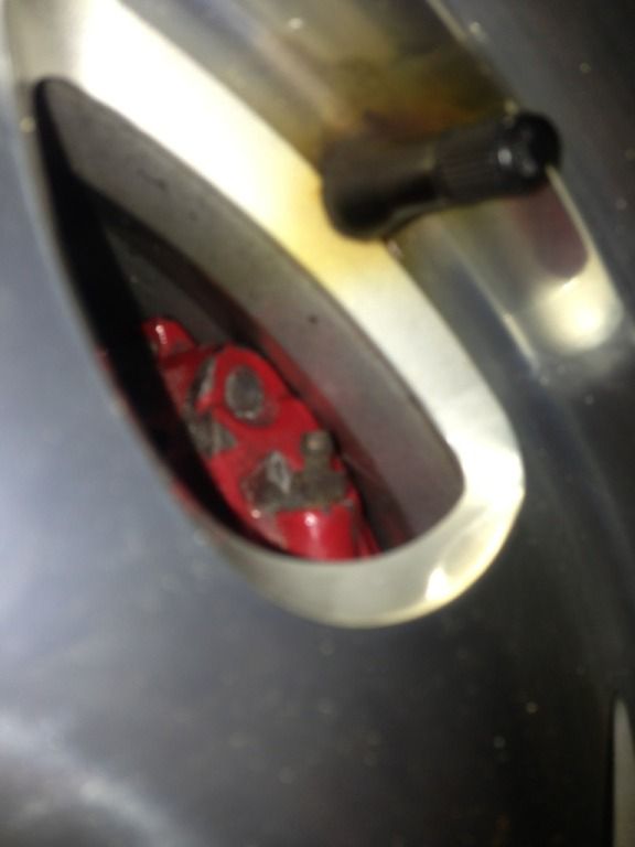

    I can't use them :(
    Either ditch the stoptechs or ditch the wheels. I'm going to need to use huge fucking spacers which is out of the question. So the wheels will be up for sale, I'm pissed because they are mint as hell.

    Where did the brakes hit?
    I'll take a pic when I get home.
