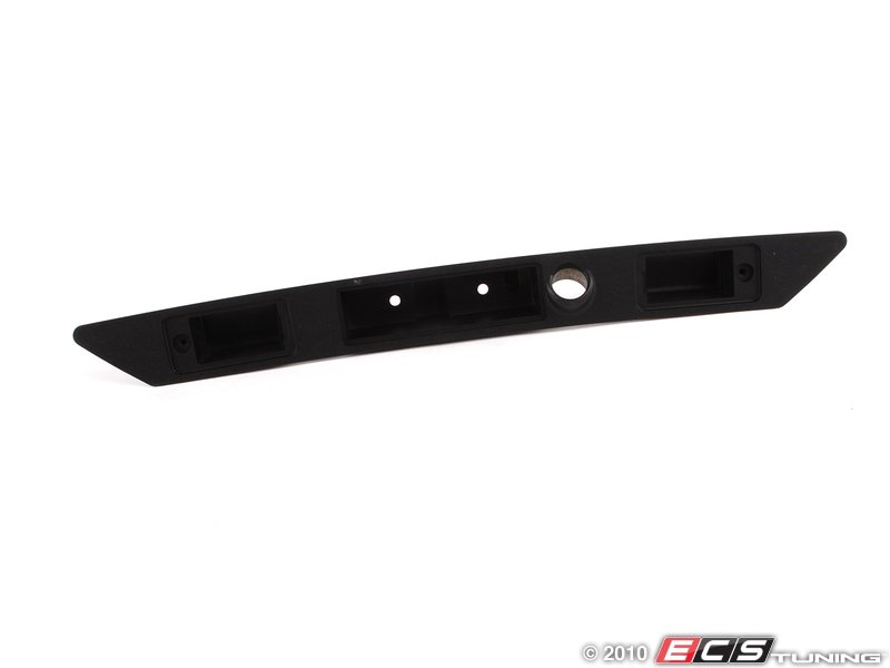

    Anyone have the part number for the full license plate light part?

    Quote Originally Posted by AUDIMAN33 View Post
    This?

    No I need the whole new strip.
    Dec 28 2006
    14483
    '13 A5, '24 Tiguan SEL R-Line
    Western Maryland
    This? Clicky click®

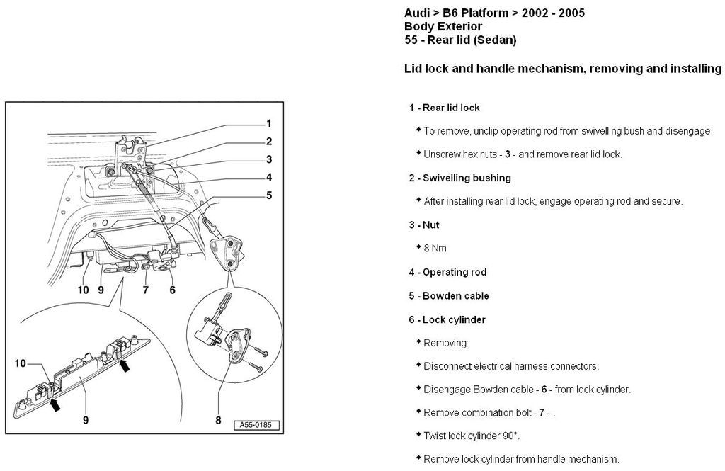

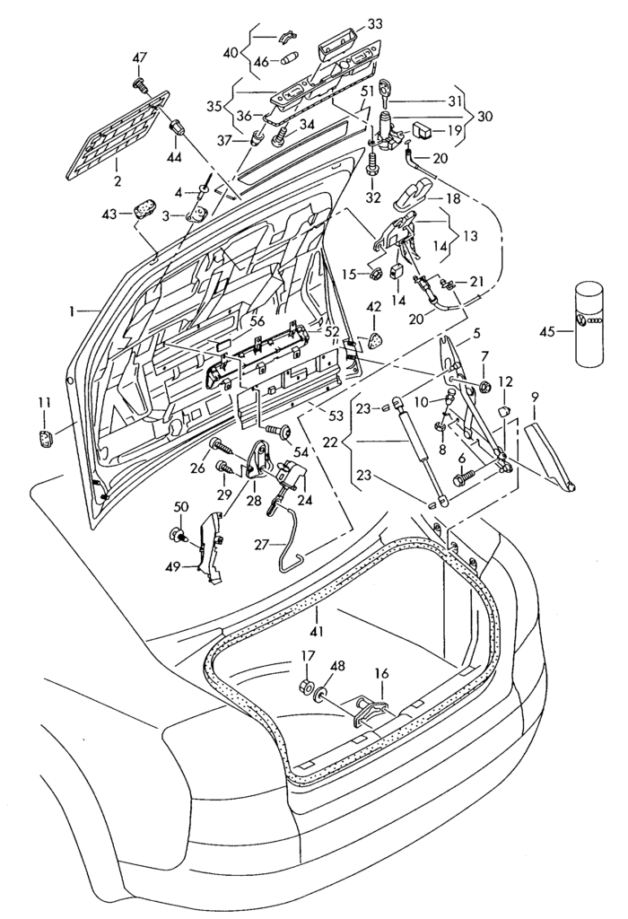

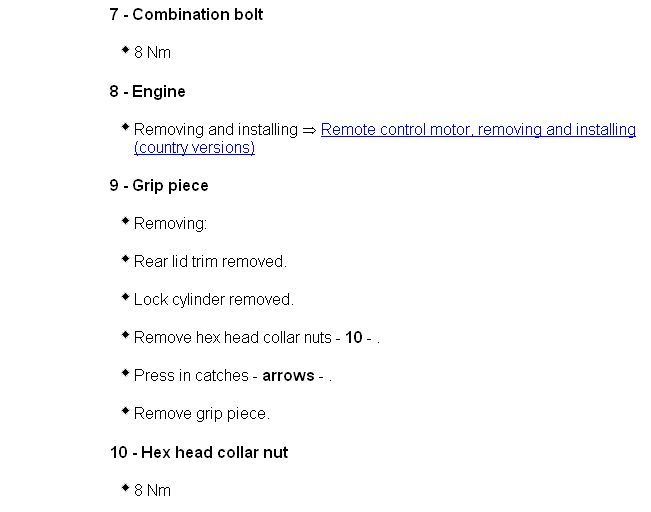

    Active Member Four Rings AUDIMAN33's Avatar
    Jan 11 2014
    138724
    Yup that's it but I want the one with the trunk handle, Idk if I can install the parts and how does it hook up? I saw they had one for like 200 something. Anyone know where to get one cheaper?
    Dec 28 2006
    14483
    Western Maryland
    Jan 11 2014
    138724
    Does that come with the trunk handle? And thank u so much!
    Dec 28 2006
    14483
    Western Maryland
    No it does not but check this out: Clicky click®
