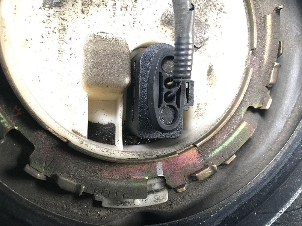

    Finally got around to taking the covers off. This is what I found under the driver's side panel. I believe this to be the problem as you can see the small traces of fuel mixed with the dirt. I'm guessing where this clip goes needs replaced? (I didn't take it apart further). I'm not entirely sure what I was looking at.

    Cracked fuel pressure sending unit was the culprit. Being replaced at Audi right now.
