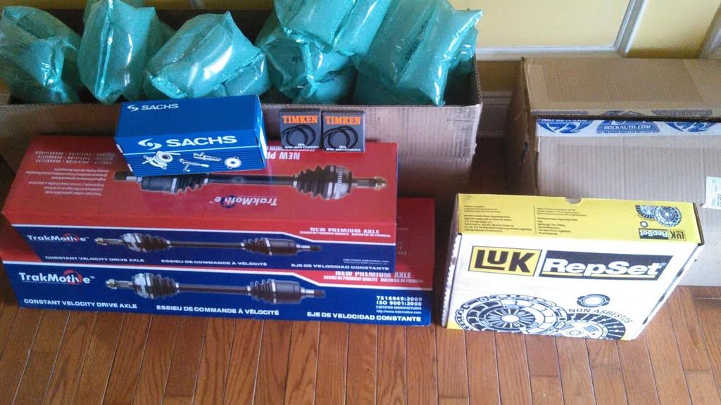

    [IMG][/IMG]
    I am about to start that very venture right now tonight. I went with the LUK pressure plate and throw out bearing from Germany and an S clutch disc. I am also going to replace the front and rear transmission seals while I have it out, the input and output shaft, as this is the perfect opportunity. I also went ahead and bought a crankshaft seal for the rear with a crankshaft cover gasket as well. I will have the trans out so now is also the perfect time for that. I will be using my stock DMFW because it is still within tolerance and in good shape overall. I will be having the machine shop mill .060 off of the outer ring to increase pressure from the pressure plate. The clutch surface was within .002 when I turned it in with a dial indicator so I will give it a good scuffing with the small Brillo pad attachment for my small air angle grinder. I have done this in the past with my BMW's and it has never failed me if the flywheel was in good shape. I will try to get some pics for the forum. As on your conundrum, South Bend imo makes the finest clutches you can purchase and there quality excels after the initial purchase as their customer service is fantastic. I ran SB's clutch set's on my 12 valve Cummins pulling trucks. Good luck and God's Speed with your build.

    Just wanted to ad with my setup I'm out about $500 but I don't plan on going much more than 320hp. So if your going to step way up there like some of these guys past 400hp my setup prob wouldn't work for you.

    It is all legitimate, the box and clutch have Germany engraved on them. From what I have gathered Rock Auto is purely in the business of wholesale to the public. The exact same setup from other retailers is $250+

    I will let you know just how good it holds in 500 miles ;/
