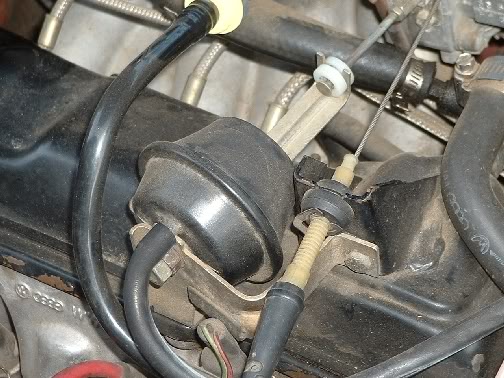

    I did a simple vacuum check on the hose and throttle airbag pump thing and didn't find anything obvious. The car doesn't start without the clutch engaged, and the brake lights work so I don't think either of those are at fault. I've heard of people cleaning those switches before? Can you clean the throttle switch? Any ideas are much appreciated, I have a 1,000 mile drive coming up that my calves can't handle without cruise control

    by "throttle airbag pump thing" do you mean this guy:

    Yep lol, I think it's technical name is the actuator
