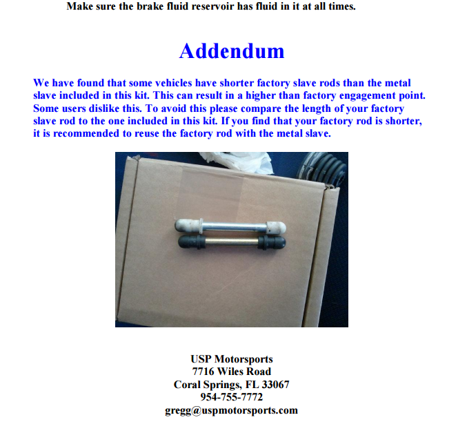

    Yes, I reused the one I had in there (the black tipped one is what my car had in it). Clutch feels fantastic with no slop anywhere in the pedal travel, here's the note on the DIY from USP as well as the link for that DIY in case anyone was curious.
    https://www.uspmotorsports.com/downl...structions.pdf

    It's a pain in the butt, definitely doable though. Make sure you use the correct length piston arm, compare the length of the one supplied with the metal slave to the original one you take out. If different in length, use the one that was in there originally.
