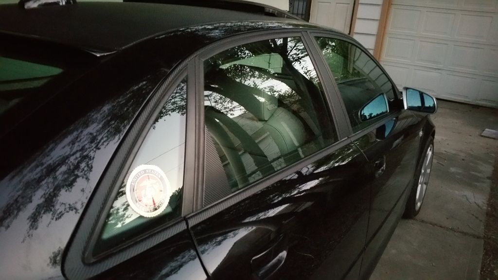

    I'd wrap it. I did it to mine and I love the look (plus it's not permanent). Pretty easy to do too.

    I ended up using shadow line window trim to wrap mine and it came out great. I was in a similar situation and couldn't justify the cost of getting a new set.

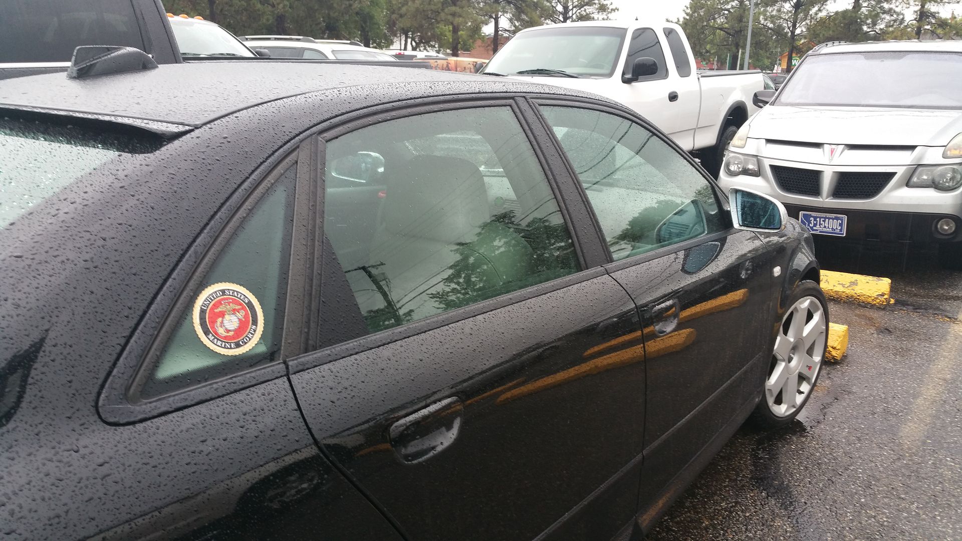

    Had to cover my trim and mirrors they were so discolored from sitting in an auction lot. Even tried professional cleaning.

    I was curious about this as well, the P.O. of my car must have hit the chrome trim at some point. It has a minor crease on the driver door. Had to be the driver door too where I see it all the time.
