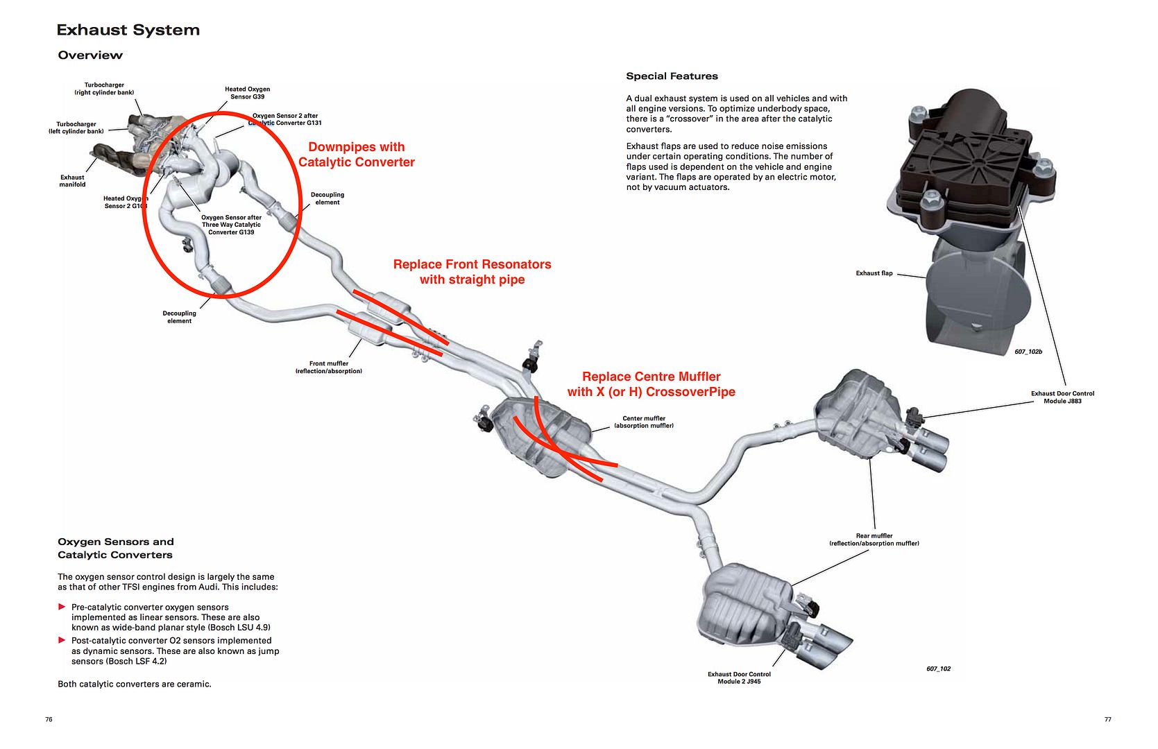

    No it will be fine. No tune needed either
    Feb 25 2014
    149321
    Texas
    No issues, many have done this. Replaced front resonators with straight pipes and suitcase resonator with x-pipe

    Are you talking about Downpipes or just deleting mufflers. Downpipes are different than deleting mufflers or resonators.
    Downpipes are a much bigger job and expense. Downpipes bolt up directly to the turbos

    Based on experience (and what I am currently running) I would recommend the following:
    Replace centre box with X-Pipe
    Replace Front Resonators with straight pipe
    Do these before you decide on replacing downpipes!
