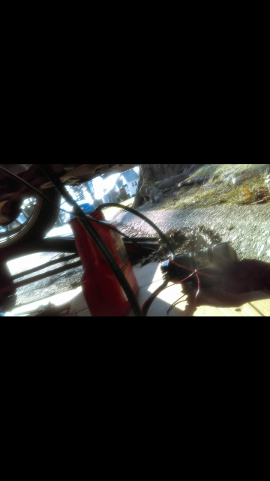

    This is where I tapped into the trans line. I ran the line going to the radiator from the trans into a 5 gallon bucket and the oil pump from the new atf fluid to the line running into the the radiator.
