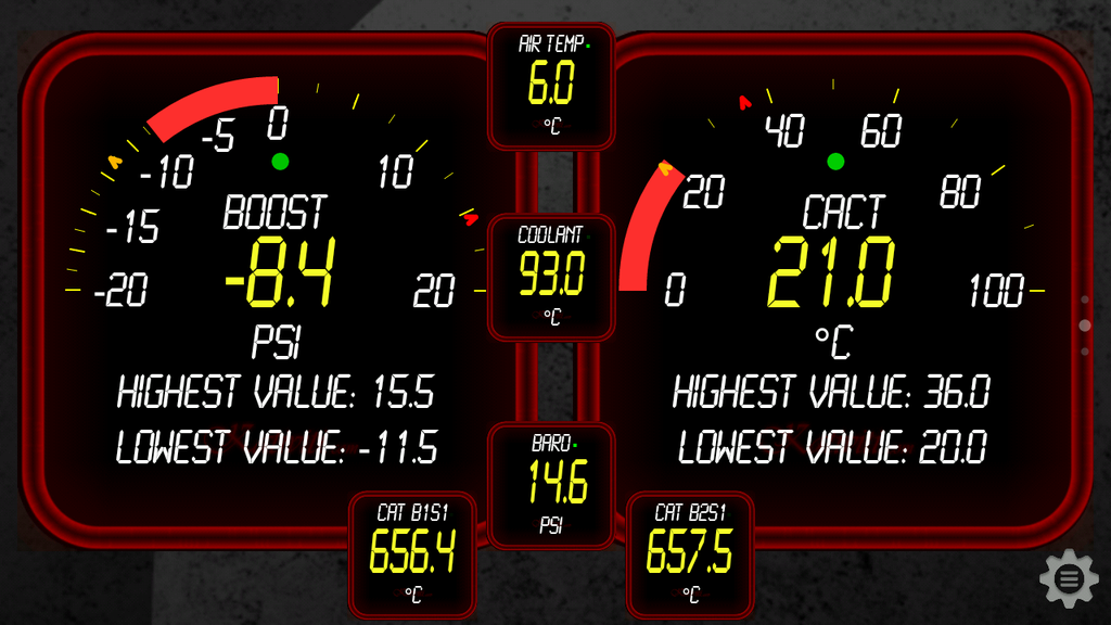

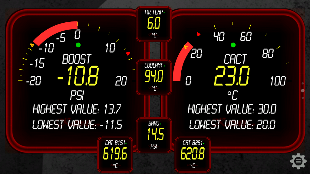

    Datalogging from a few nights back:
    Engine Coolant 93*C (199.4*F)
    IAT 24.25*C (75.65*F)
    Ambient 68*F
    vehicle speed = 55mph (I think this is important to note as well, it plays a big factor in our IAT's)
    Set-up: AWE pump, AWE reservoir, KillerChiller refrigerant liquid-to-liquid HX, front mount HX delete.

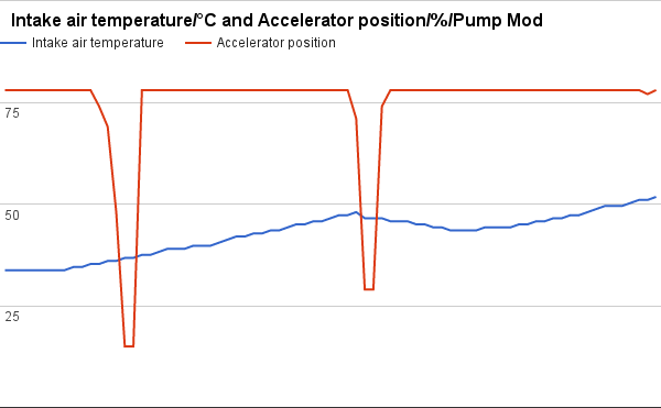

    Here is a a graph I did when testing my stacked heat exchanger.
    It is a 2nd,3rd,4th gear pull so 30-120 or so MPH
    The outside temp was 21*C (69.8*F)
    Starting IAT was 33.75*C(92.75*F)
    IATs' maxed at 51.75*C (125.15*F) @ 6,660 RPM
    I didn't log engine temp though

    Brilliant graph man. Nice results!

    Senior Member Three Rings xpoweruk's Avatar
    Feb 05 2016
    368290
    UK
    Anything over 60*C & you start to lose power I think IIRC Loe noticed this during DP testing

    40MPH
    70MPH
    Custom stacked chargecooler
    revo Stage dual pulley with revo intake
    Milltek ValveSonic Exhaust Q5 Brembo 4 Pots
    18x9 Wolfrace ProLite alloys
    Eibach rear ARB & Eibach springs

    Hello,
    Here is the IAT during a sort of 1/2 mile event with 50 km/h Rolling start. WOT 2-3-4 and a little of 5
    Ambient temp was around 55°F (12°C)
    Will do the same again, with and without the AMS/Alpha cooler
    Cheers,
    Mat

    I upload the log to Google drive,then open in sheets.You can then select the columns you want to graph & it is done in a few clicks :)
    The below image is your 3 runs bhvrdr
    and a comparison between yours & my IATs'
    I'm revo 1+ though & you are DP
